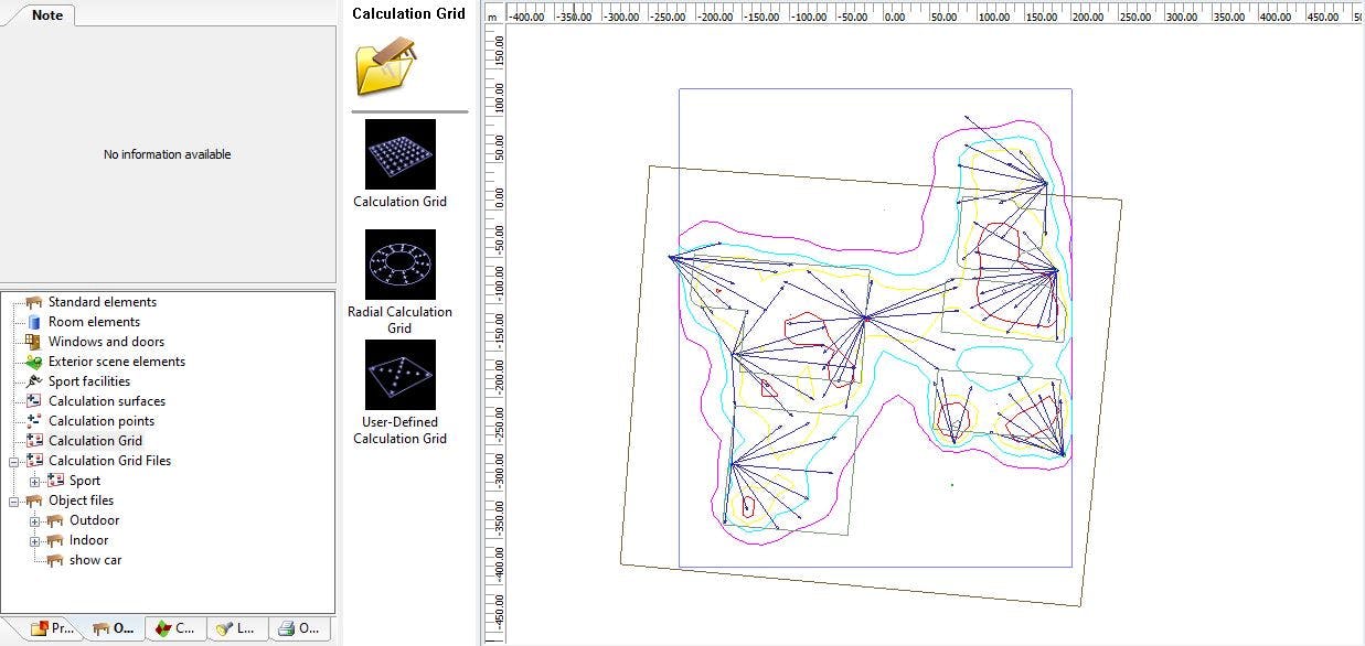

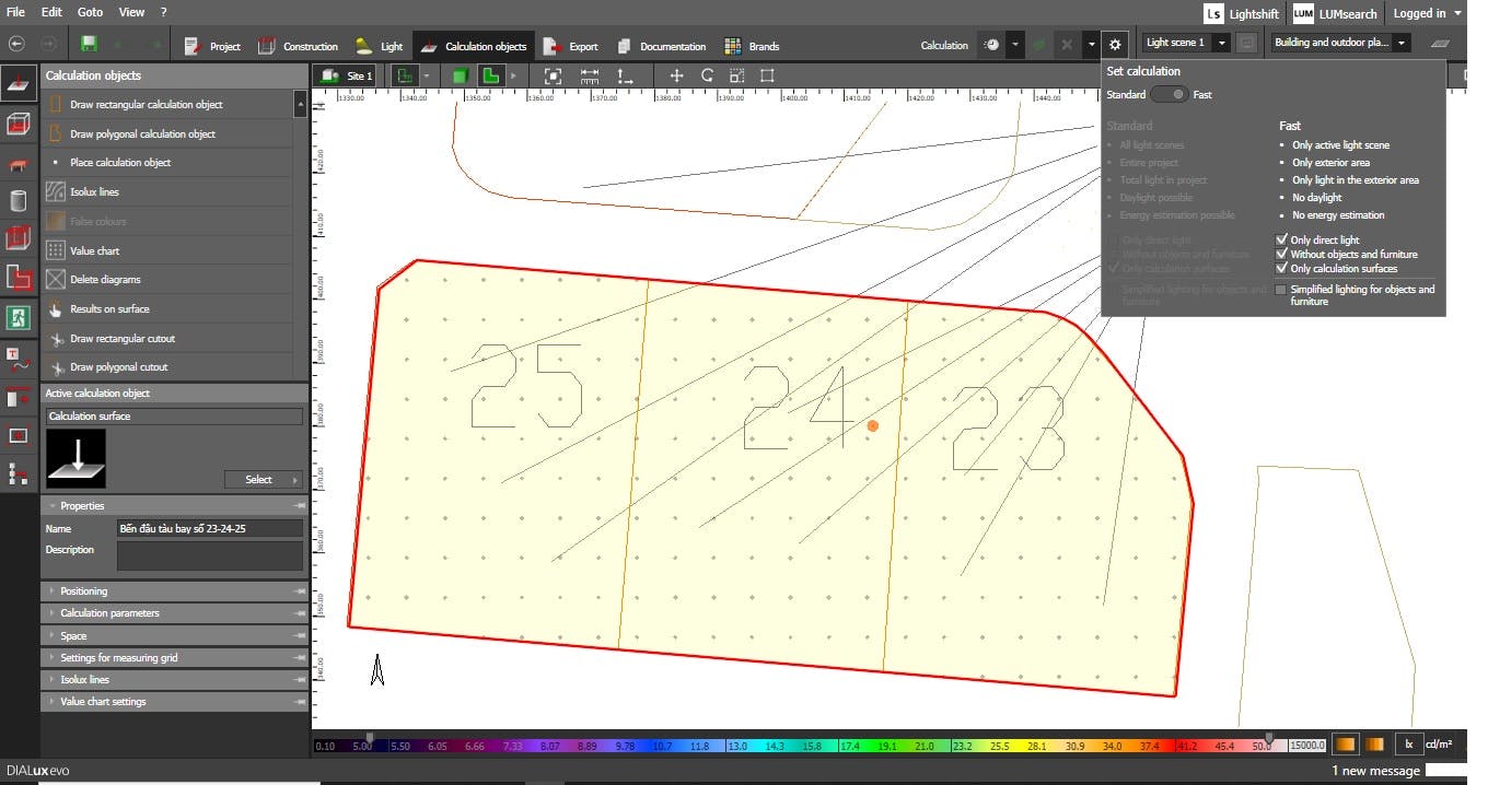

1. I still using DIALux 4.13 because of the intermediate results and quick viewing. So, I still want to use this helpful tool in EVO and I try using the "fast" tool, and not thing happened

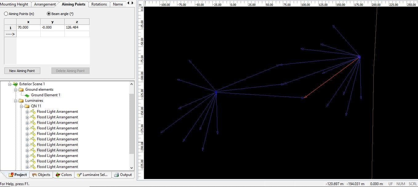

  1. Almost time, I use DIALux to design the outdoor lighting. When I use EVO, the aiming point arrow is so tiny and very hard to view than I use DIALux 4.13 (I just use the mouse pointer to drag the arrow and the iso-lines change, it helps me to complete the project faster than using EVO)

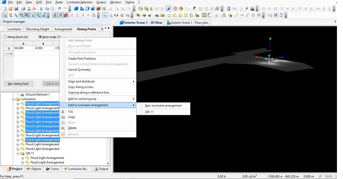

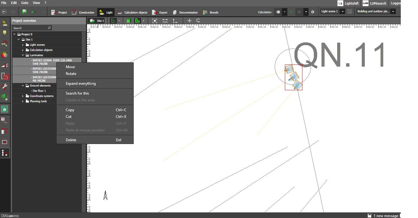

  2. The difference between EVO and DIALux 4.13: DIALux 4.13 can group luminaires but EVO can not (or I'm not finding this tool, you can show me the solution)
