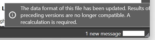

I installed version 13 today (my previous version was 12.1), but now my project file won't open. A message appears during the opening process, and then the loading bar stays stuck near the end.
The file size is large, and while it was slow to open in the previous version, it won't open at all in this new version.

Opening large projects can take a long time. Some geometry information has to be regenerated, which takes time. This also means that the results no longer fit and have to be recalculated, hence the note.
Once you have saved the project again with the new version, this will of course not be necessary next time.
