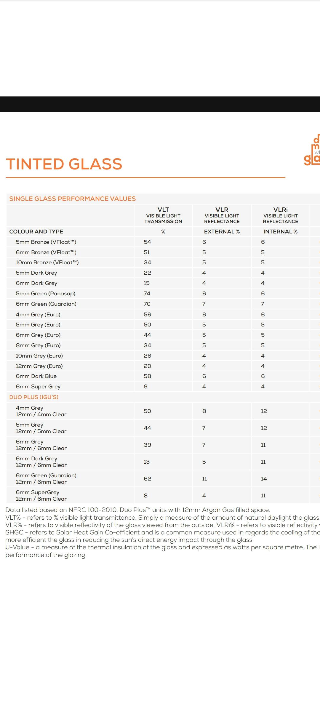

Are degree of transmission and VLT same?
I have project that use green glass and I found this datasheet about green glass. Degree of transmission and reflection factor are parameter that uses in dialux. My question are VLT similiar to degree of transmission and reflection factor similiar to VLR?
