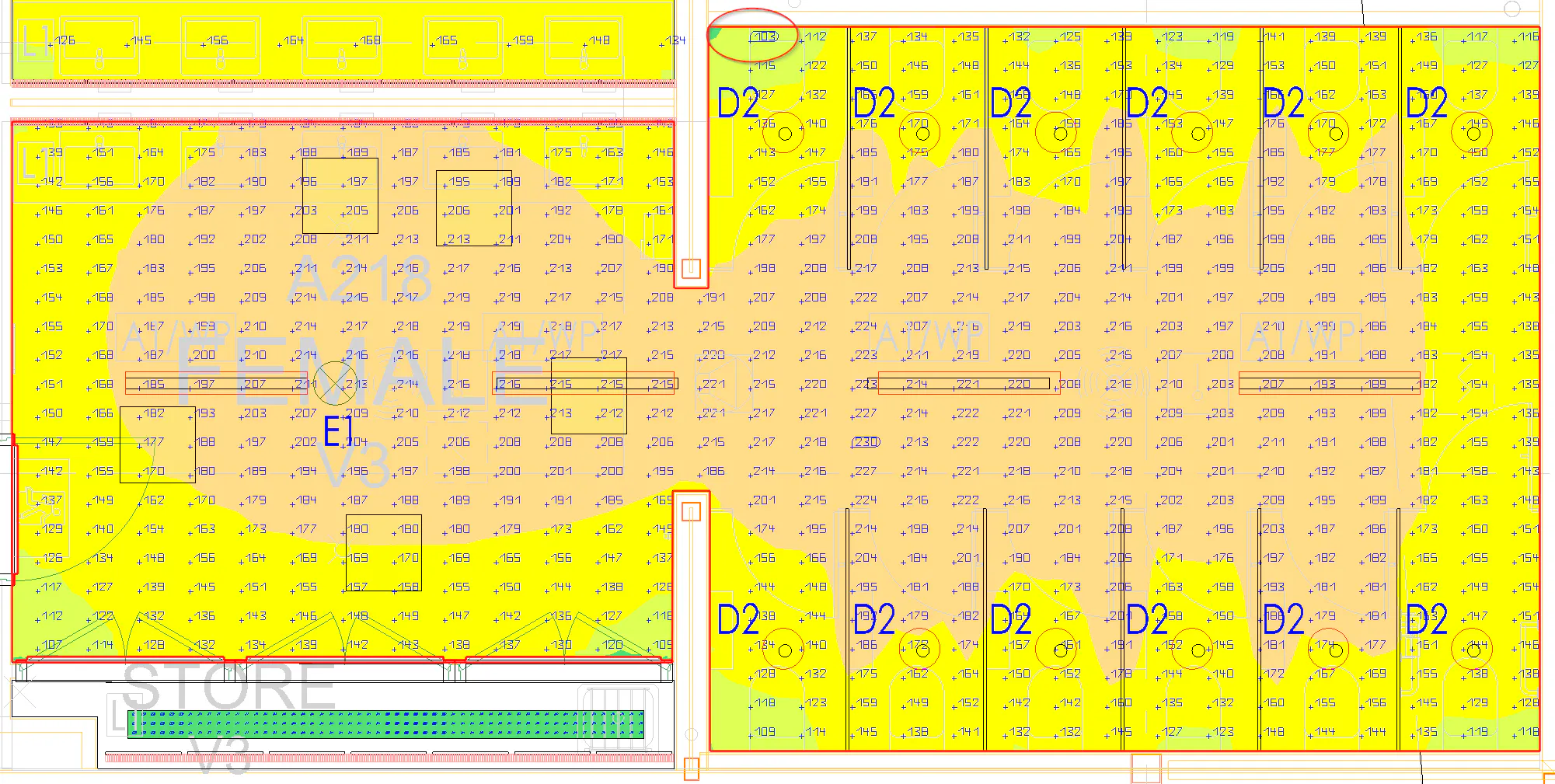

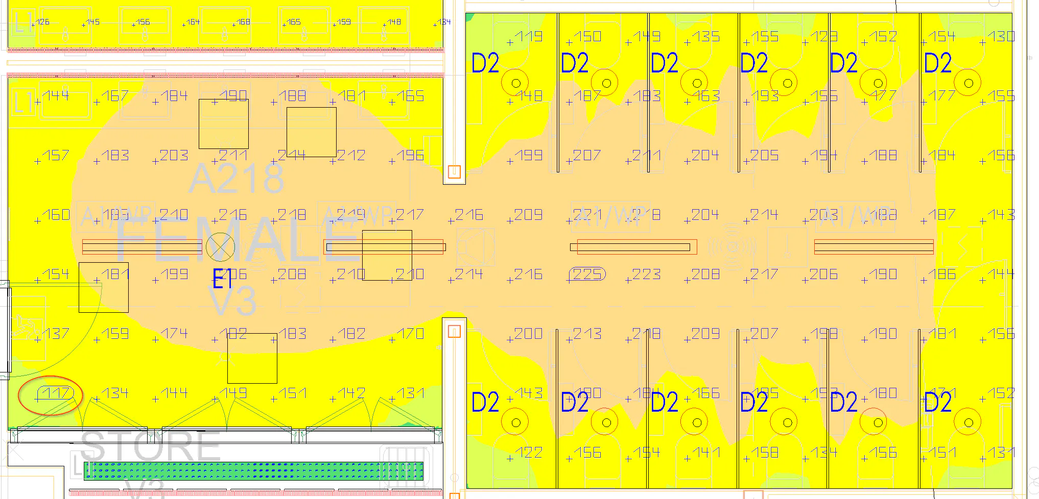

I noticed several times that the automatic value chart in a space highlights the minimum value at the wrong location.
To find the minimum value you must increase the quantity of grid points
