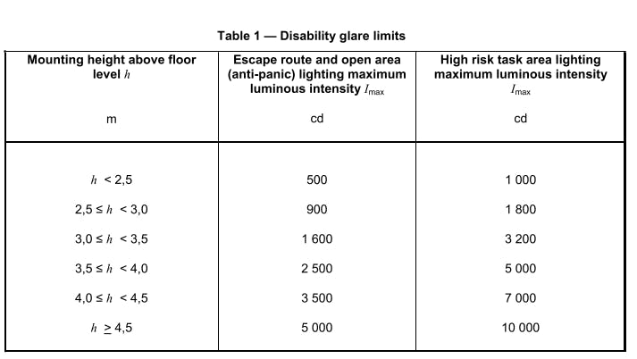

BS EN 1838 - 4.2.3 Emergency lighting disability glare
I have been asked by a client to present calculations/proof of compliance for BS EN 1838 section 4.2.3 which relates to limiting emergency lighting glare for disabled. There is a table in the standard with disability glare limits and has limits in lighting maximum luminous intensity measure in candellas.
I can't seem to find where to get or calculate these values in emergency lighting calculation mode. Any help is greatly appreciated.
