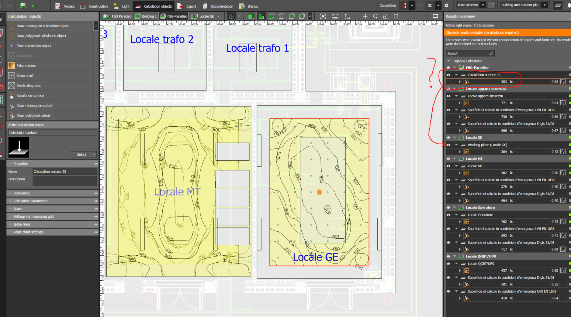

Calculation object outside the walls of a room, even if the borders of the calculation object are inner the room
Hi,
I have a building, with several rooms. When I add a calculation object inside one room, it goes outside the room in the list of lighting calculation.
The name of the building is "FSG-Paradiso"; the name of the room is "Locale GE". I would like to shift the calculation surface 35 into Locale GE
Best reply by Emil
Select calculation object you want to move, then go to spaces properties and assign to corresponding area
