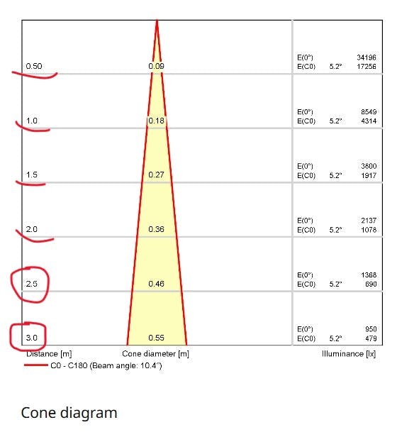

I have an issue about changing the distance intervals of cone diagram reports. As seen in attached image below, I need to get results for different distance intervals like 1 to 5 meters distance.
Is this distance interval is an industry standard or can be changed inside the DIALux Evo 12.1

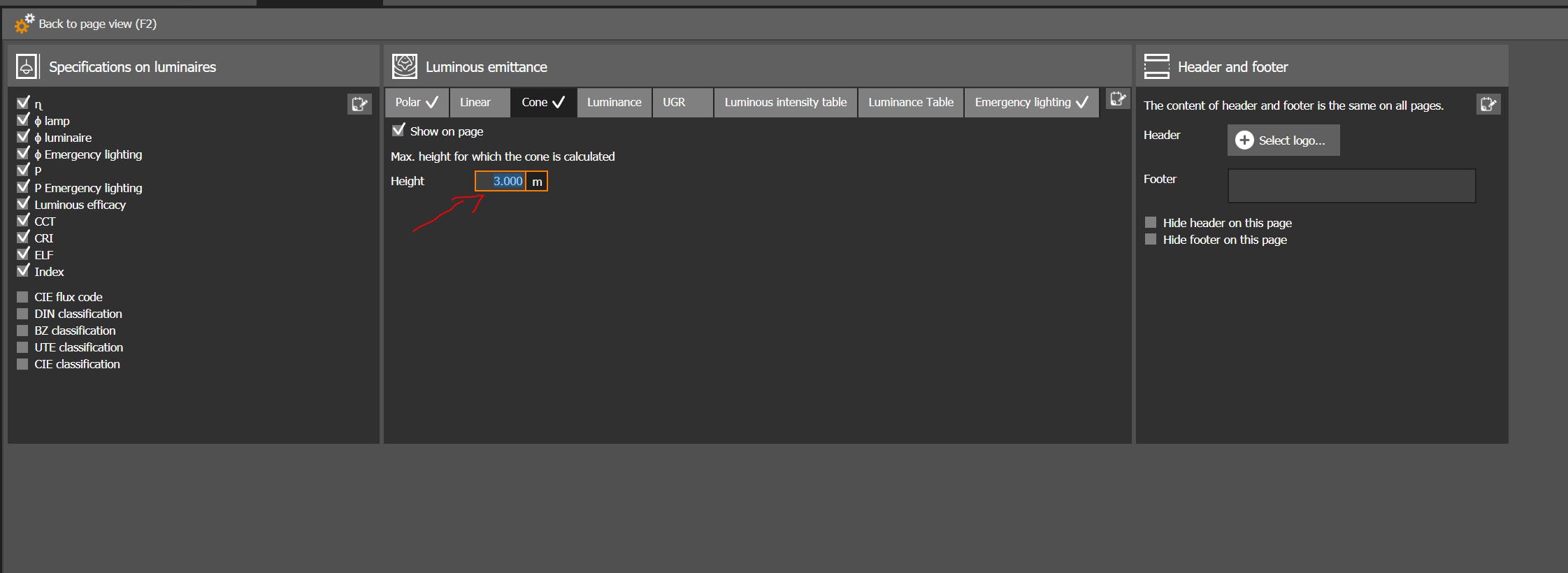

Hello,
You can set the height for the cone diagram with F2. The starting value is always 0m, otherwise it would be a "truncated cone diagram".
The distance is automatically determined so that the diagram is easy to read.
