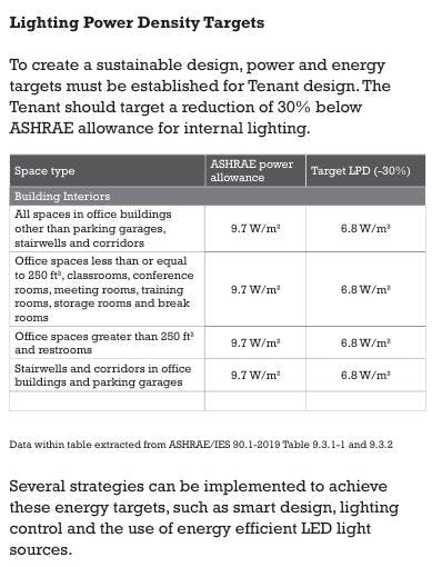

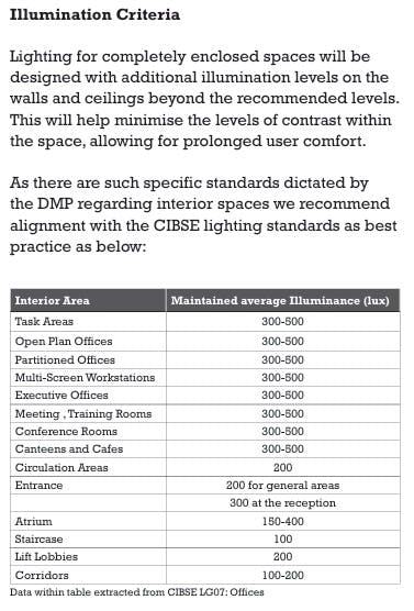

Data within table extracted from CIBSE LG07: Offices relevant complying standards equal to with the present in dialux software ? and the lighting power density targets ?
