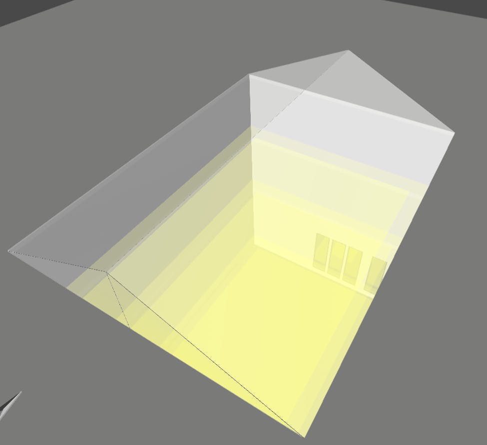

Im going to calculate the daylight in this room, which extends over three floors. I have used the "cut out" function to make a cut-out in the floors, which appears to work.
But, in the daylight calculation it wont work. I get daylightfactor=0.0%. Anyone else struggling with this?
