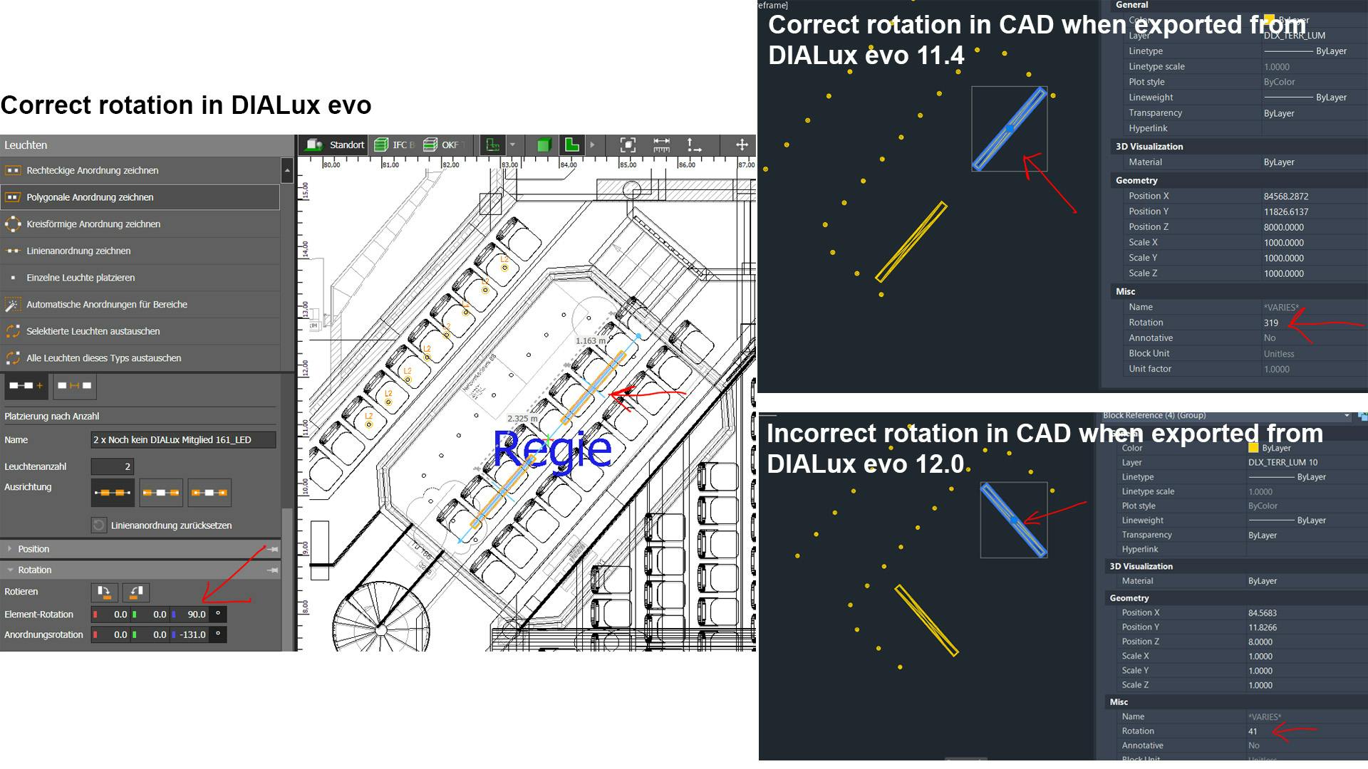

I have noticed that when I export luminaires from quite a complex project (theatre auditorium) to DWG file, some of the luminaires appear to be exported with wrong rotation. I have exported DWG from this same DIALux file with previous version (DIALux Evo 11.4) and the rotation upon DWG export seemed to work fine.

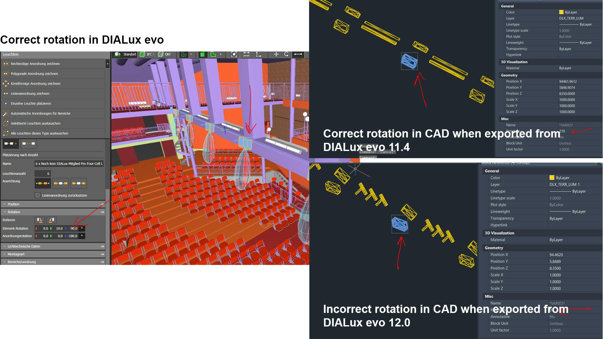

To add to confusion, some of the luminaires of the same type were exported with correct rotation, while the other were not, so itΒ΄s not the type of luminaire. It is not an angle of rotation either, as some luminaires with non-orthogonal rotation were exported correctly, while the other were not. I was not able to establish any kind of logic in why some luminaires were exported with correct rotation to DWG and the others were not and therefore not able to prevent this.
Example A:
Example B:
