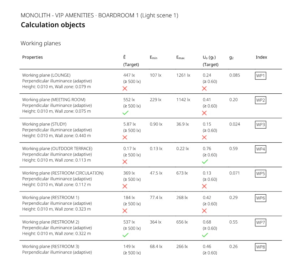

I need some help with getting specific units to show up in the documentation report.

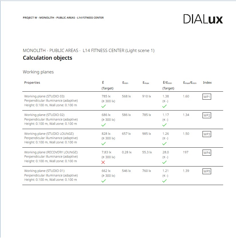

Currently I am getting E/Emin and Emax/Emin showing up in the 4th and 5th column but I need u0(g1) and g2 to show up. I don't believe I have messed with any settings to get it to look like the first screenshot.
First image is when I generate a report and second image is when one of my co-workers generates one.

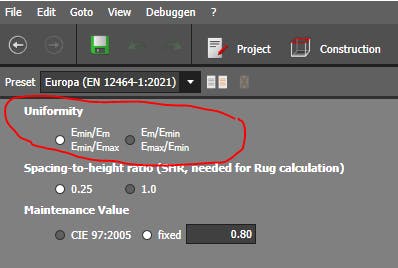

I think two things are mixed up here.
1. The designation Emin/Em vs u0, that was changed at some point and Emin/Em is the current version.
2. You can set whether you want to see Emin/Em or Em/Emin. The setting is somewhat hidden under File->Settings->Standards
