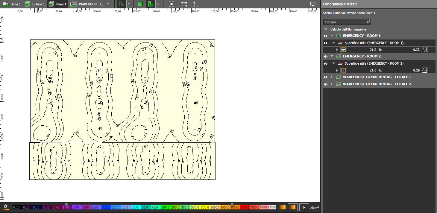

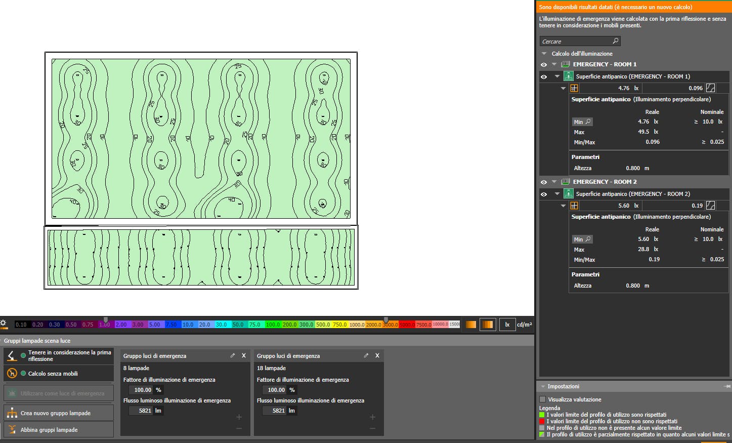

good morning,
I have a problem that I can't solve, if I set an emergency light scene and assign the 100% efficiency percentage to the lamps, the values ​​that the software returns to me are clearly lower (4.78 Lx) compared to a normal light scene with the same values ​​(21.2 Lx)
I need to have the same values ​​that were calculated in the normal scene also in emergency
