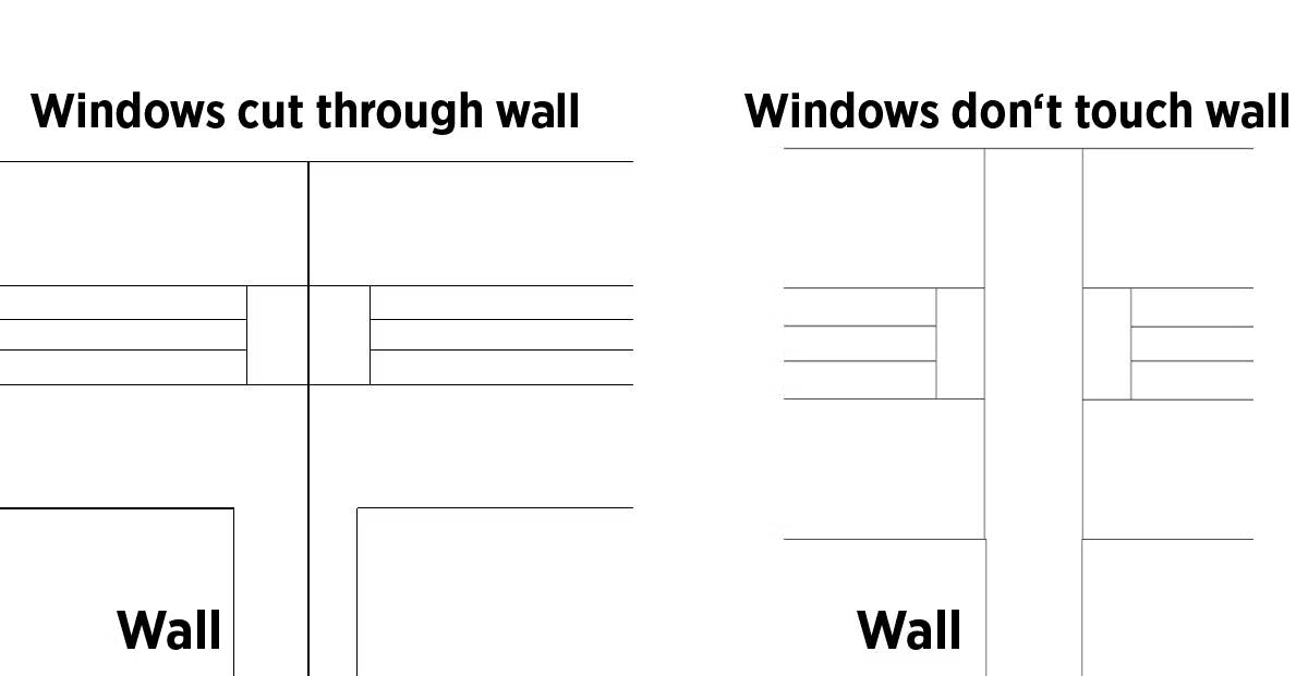

Several random cutouts have appeared in my model. There is no way to select them, but when i run a lightscene these cutouts are seen as real openings. This makes my simulation incorrect.

Hello, try to enable "vaste snijdiepte" and set snijdiepte value to half of the outer wall thickness.
But then your rooms will not be closed completely. Better reduce to reduce the with of the windows.
