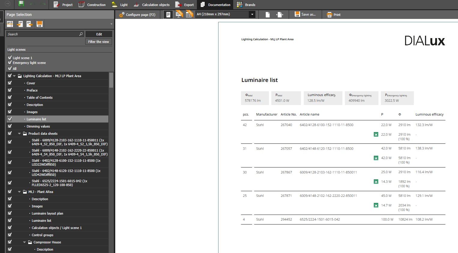

Every luminaire is showing as emergency luminaire in the report generated.

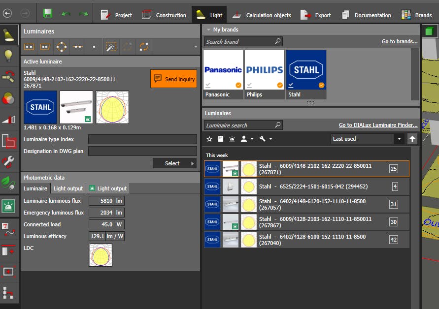

The project was designed having normal luminaires as well as emergency luminaires. We used 5 luminaires for our project out of which 2 of them are emergency light. In the designing stage everything was showing properly. But when we generated report 4 out of 5 is showing as emergency. Please see the screenshots.

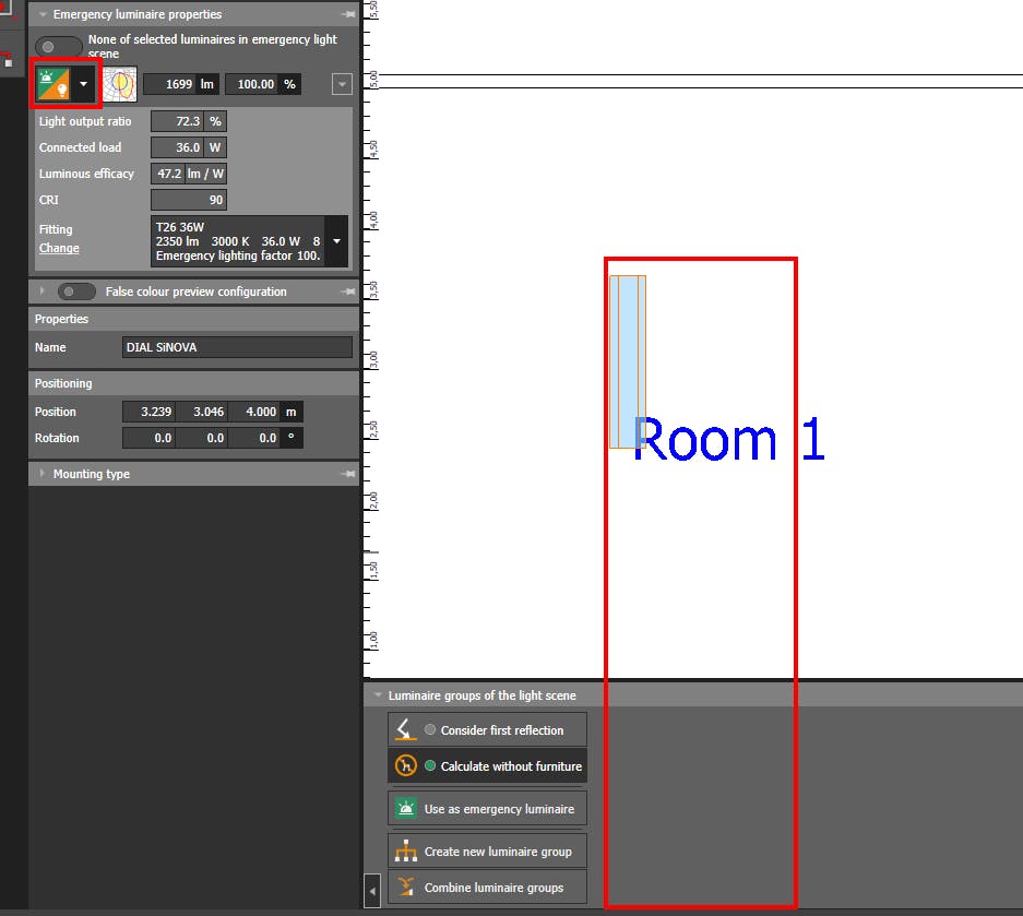

This can happen if you have set at least one placed instance or the prototype of a luminaire to "mixed" mode in the emergency tool.
Even if this luminaire is in no emergency luminaire group in the emergency light scene and thus won't be calculated in the emergency calculation, it will still show up as an emergency luminaire in the documentation.
Please check whether any placed luminaires that are not supposed to be emergency luminaires are set to mixed mode in the Emergency luminaire properties configuration. If this is the case, change that for all of them and the luminaire prototype as well. To change the prototype, deselect all luminaire instances in the CAD and change mixed mode to "use this light output in normal calculation only", i.e. the entry with the yellow light bulb icon in the drop-down box.
