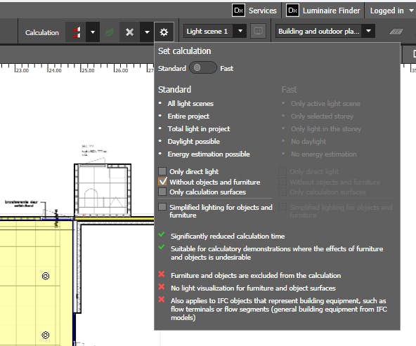

I'm working on some calculations where the tables and couches are influencing my uniformity value. Is there a way to disregard furniture in calculations? i know i can calculate without the furniture first or place cutouts on the work plane but just wondering if there's another way.

Hi! I hope I understand what you mean correctly, but from what I know you can tick the box "Without objects and furniture" in your calculation settings
