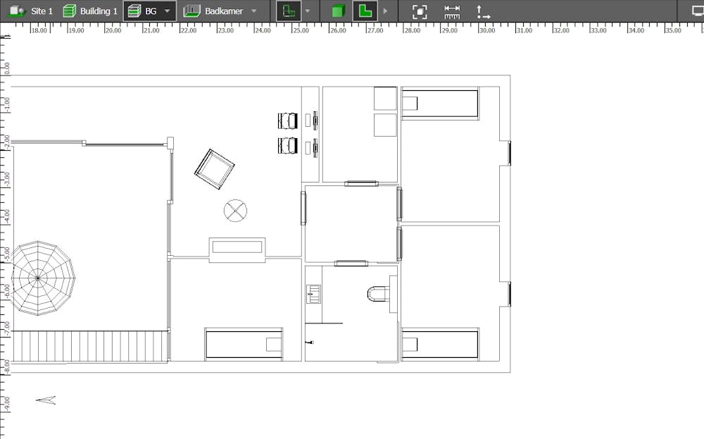

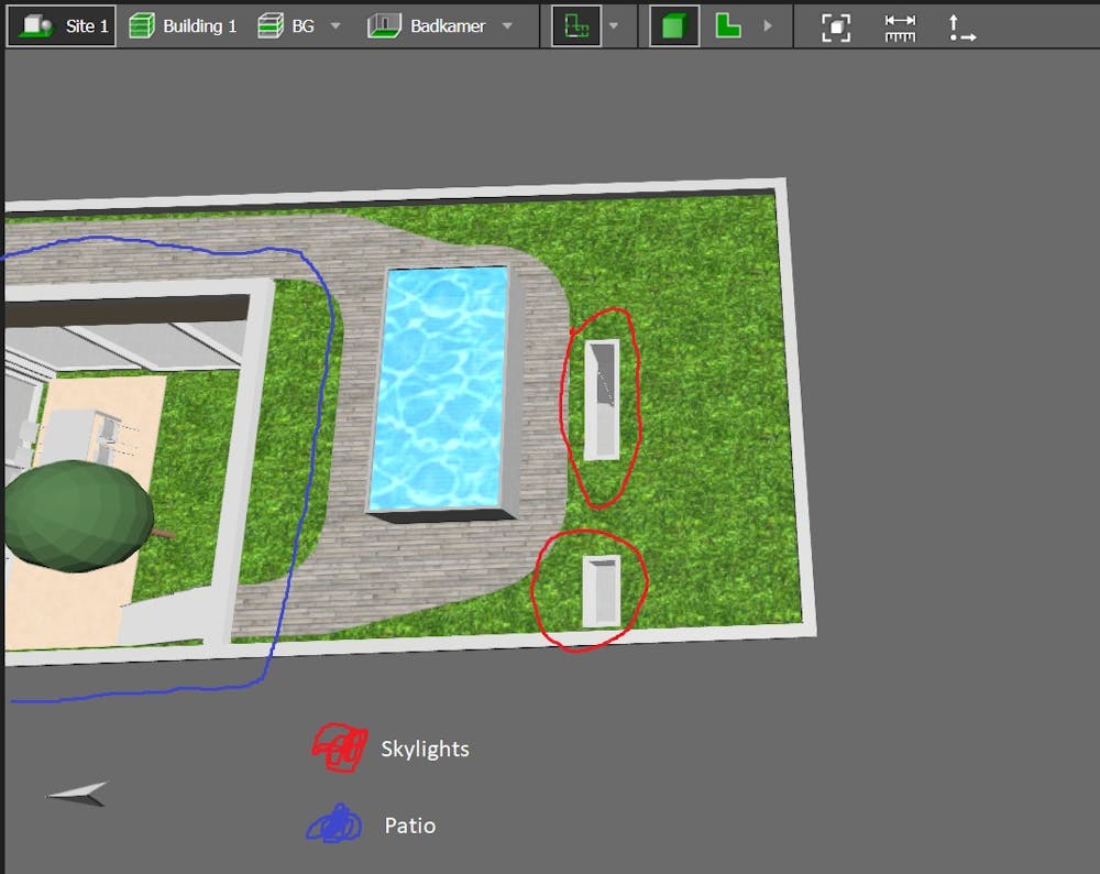

I am trying to calculate daylight using DIALux evo 11.0. When I run the calculation, I only get results from the windows in the wall (see 3th photo). My project has two patio's and several skylights.
Q: How can I get calculation results from all these factors instead of only the windows placed in the wall?

1. Floorplan ground floor:
  1. Below the negative volumes and skylights:
