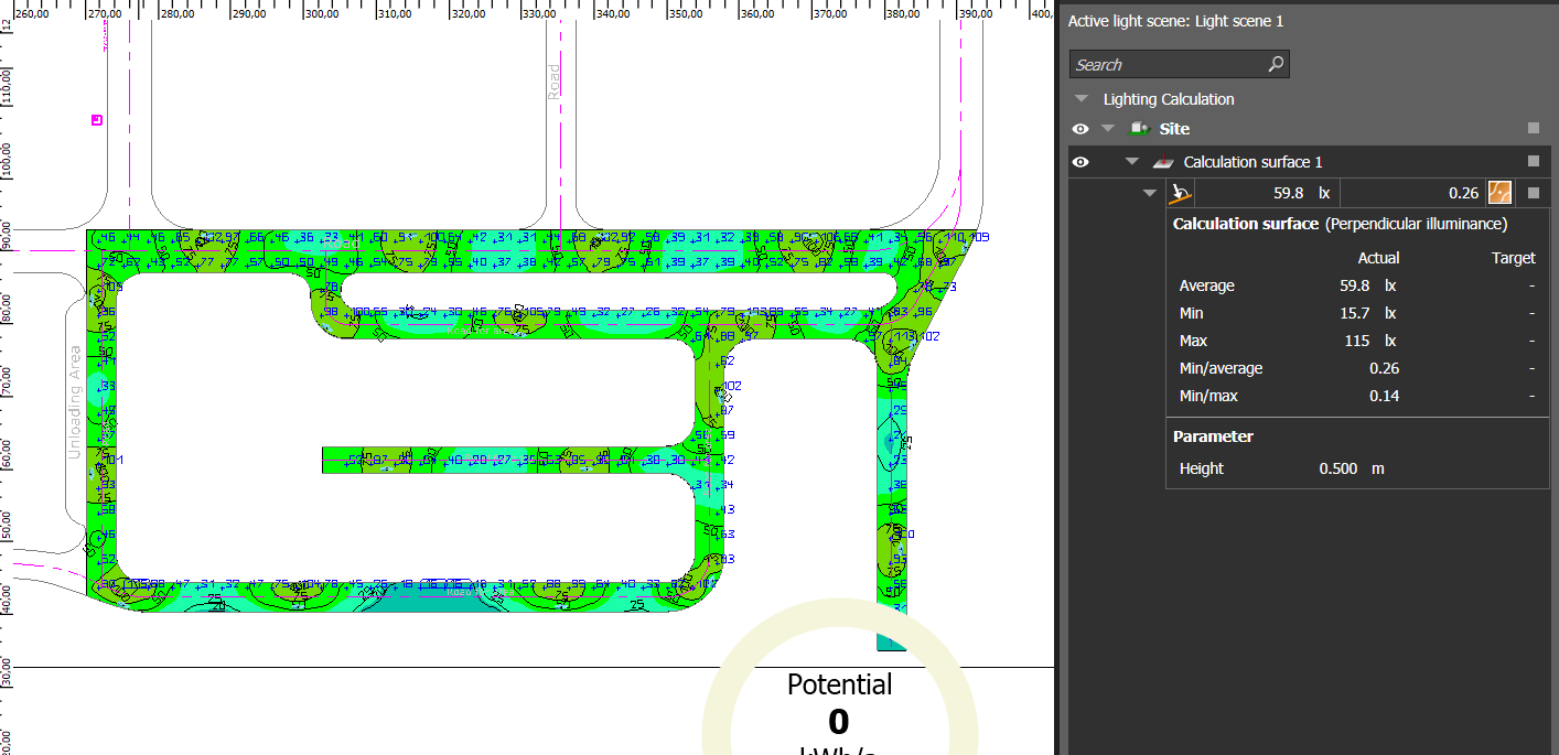

i want to design a lighting for streets so instead of using street lighting option, i work with calculation object, the reason why; it's because "street lighting" option let you work on a sample road and in my case i had complicated roads (see photo 1) that requires to design it all properly in way to work on all scenario (crossroads, intersection, Narrow and Wide Ways..).
photo 1:
so i what i did is, drawing my plane using polygonale calculation objects & i draw i polygonal cutout to delete the surfaces that not included.
in results : i want to have +20 lux & +0.25 in uniformity.

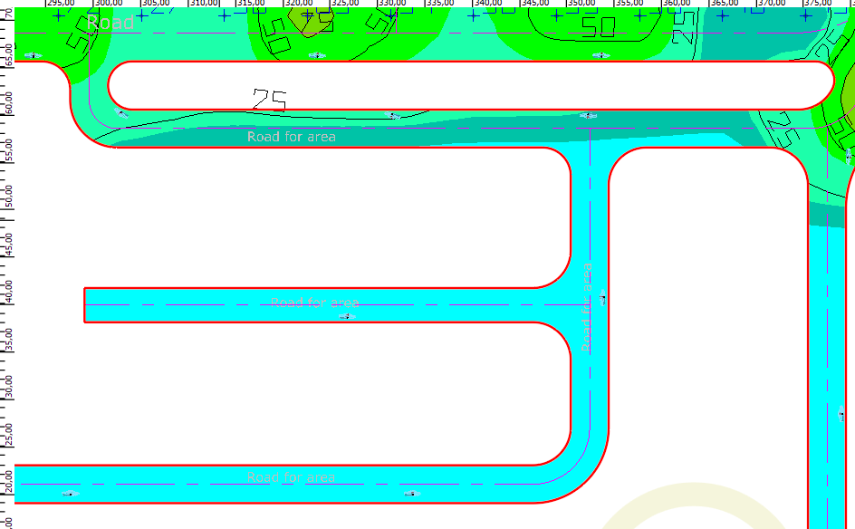

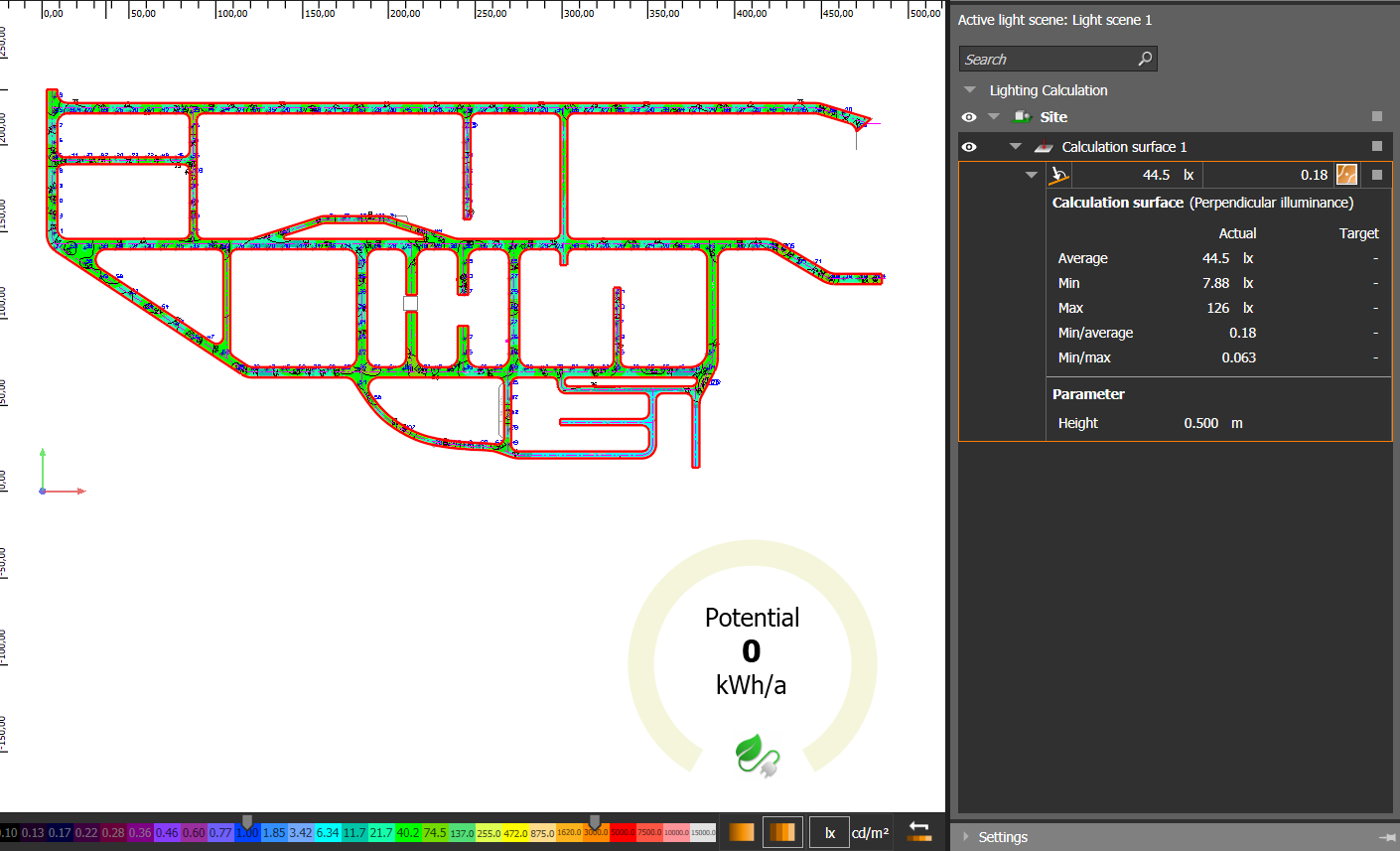

i choose my lighting luminaire (150 W), & i run the calculation ( see photos 1,2 to see the results). what happen is the calculation was perfect in the majority of my plane except some roads & surfaces that appear in the calculations diagrams like there is no luminaires at those places THIS IS MY PROBLEM !

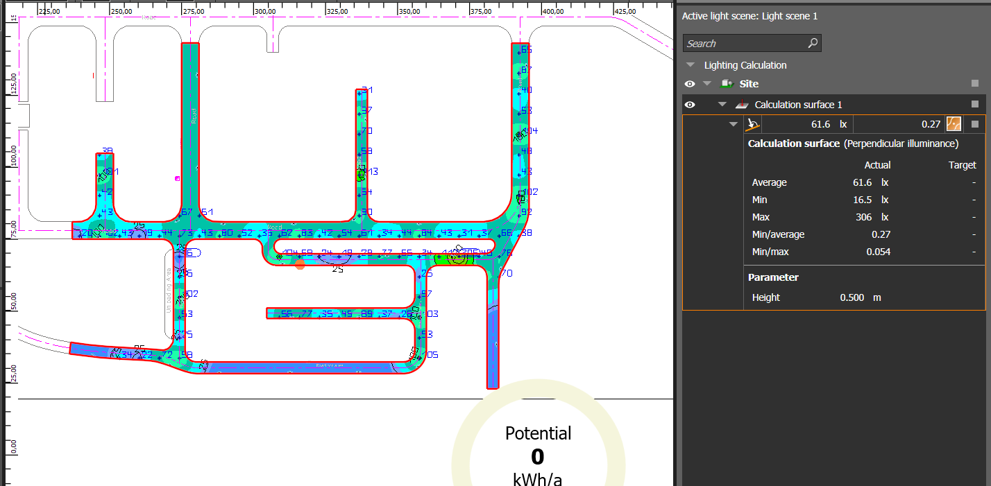

test 1 : i draw The smallest possible suface near to those areas and guess what the calculcation was good (see photo 4)

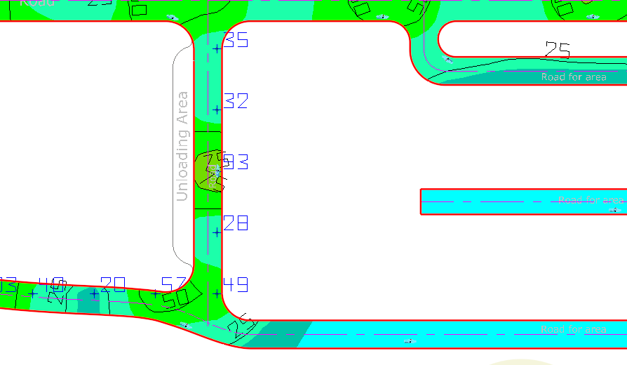

test 2 : i draw another surfaces but this time it's a little bigger than the other. i run the calculation same problem those areas appear in the calculation like there is no luminaire on top of them.(see photo 5)

Hi Yas, the issue there is that calculations measuring points for these types of calculation surfaces are adjusted autamically thus in most cases it will do in incorrectly.. as you can see below there are more calc points on the top area then the lower one:
you`ll need to adjust the number of points manually by accessing these settings / make sure to set it up 128x128 points and re-calc, this should get you more accurate results:
Hope this helps!
