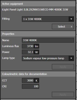

I have noticed that lamp type doesn't follow what the actual luminaire that is being imported into DIALux evo. As far as I know, IES or LDT file is unable to determine/set the lamp source as certain lamp type. As shown below, Panel is LED, but lamp type is shown as HPSV light source. At the same time, the CCT and CRI are also by default - 3000K 100CRI despite the IES file stated otherwise.
