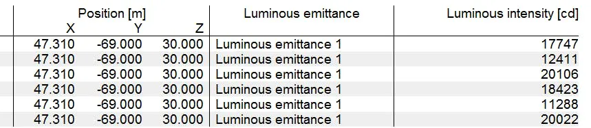

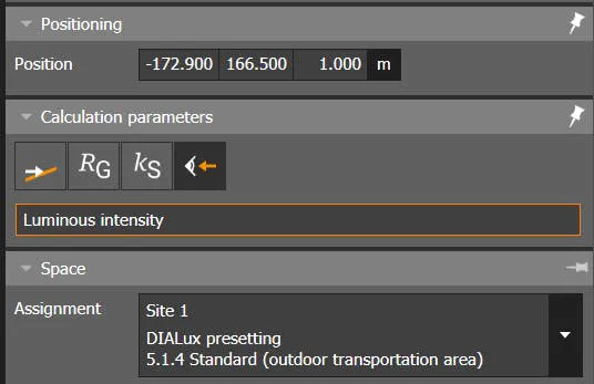

I have built identical setups in Dialux 4 and Dialux evo and my purpose is to make sport lighting calculation with obtrusive light included.
My illuminance values are the same which confirms my setups are identical, but for obtrusive light in Dialux Evo I'm constantly having 0.00 cd, while in Dialux 4 I'm getting +20 000 cd in the same points. I'm getting candelas in evo only when I purposely target a luminaire to calculation point but that's it.
Dialux evo only reports one maximum value while in Dialux 4 I'm able to see value for each luminaire in the setup which makes it more informative.
This difference is very alarming to me.
Dialux evo:
Dialux 4:
