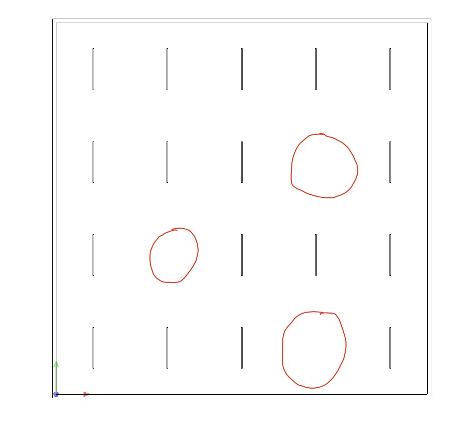

The second problem is in dialux evo since I think version 10. If I have an array of luminaires (for example 4x5 luminaires) and I manually delete some from this array (as picture shows) and then use the function to replace all luminaires, the array will put all deleted luminaires back. It was not like this in older version of dialux evo. Is this a feature or a bug? Because in my opinion it is not ok if the program puts back the luminaires I have already manually deleted. In big projects where I need to check different types of luminaires it is creating a lot of double / triple checking.
