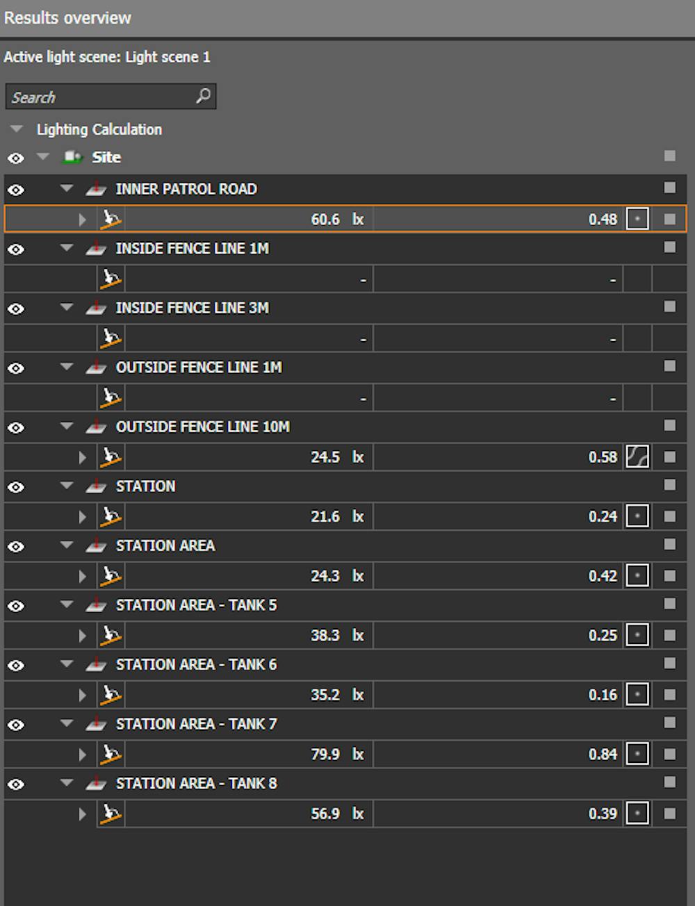

Dear all,
I need your help as I am facing a problem when I calculate some of calculation surfaces have no result as shown in attached image.

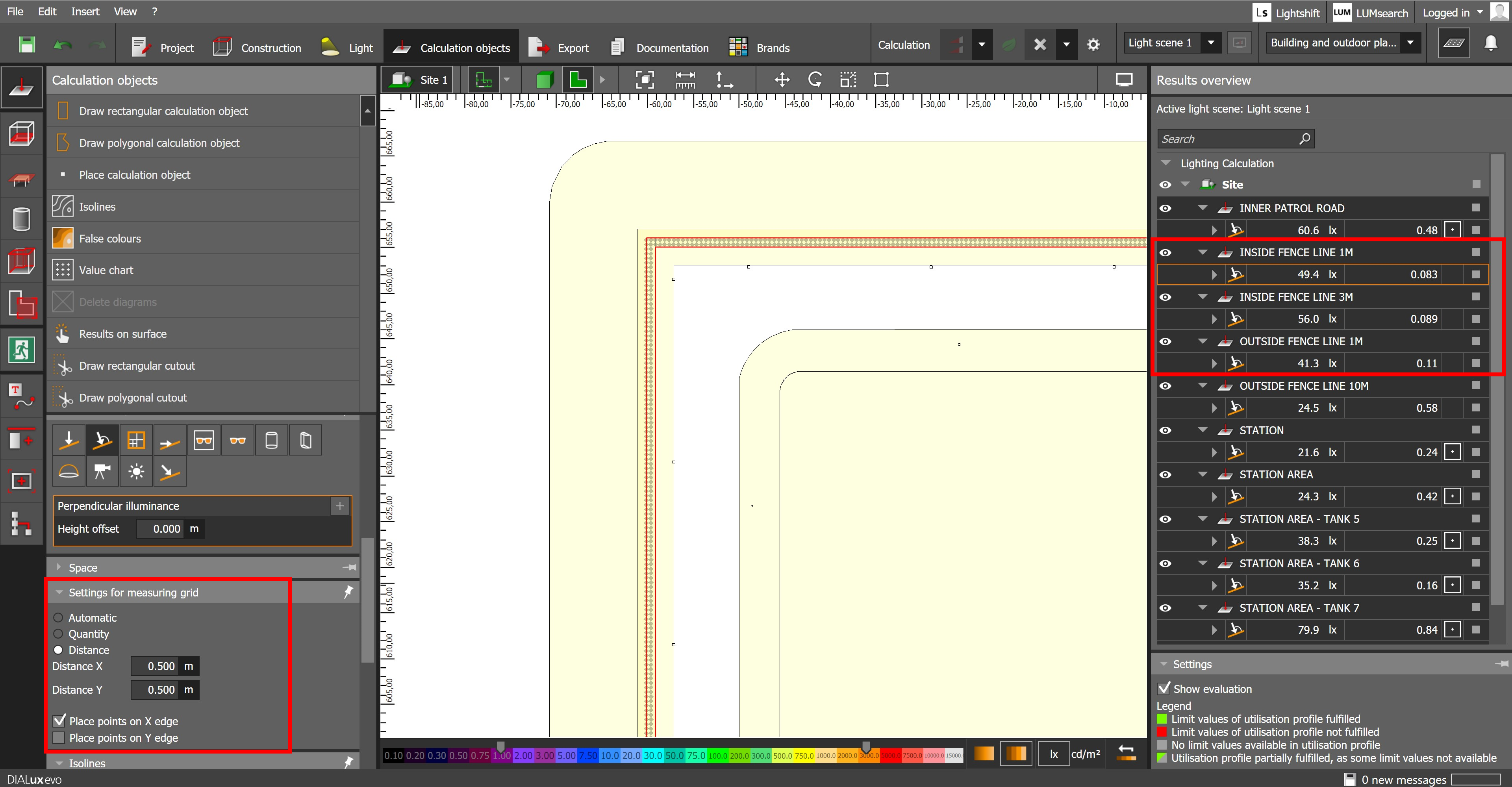

The cause of the problem is that the three problematic calculation surfaces are very narrow. Therefore, no calculation points can be found on the surfaces there with the automatic measuring grid. If you set the measuring grid to distance and e.g. to 0.5 x 0.5 m and recalculate the project, you will also get results for these surfaces. Please have a look at the screenshot below.
