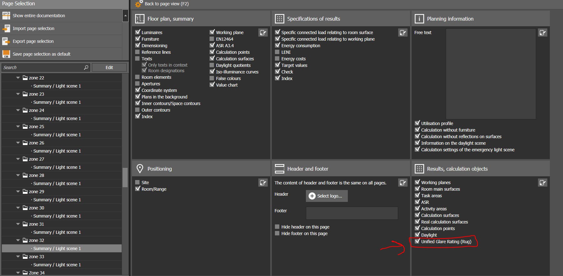

So, what i'm looking for is to show the dimensions of each calculation area in the documentation.
However, dimensioning is not yet implemented in evo.

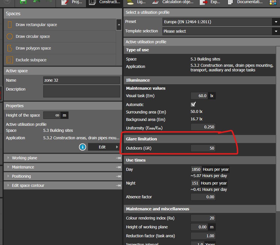

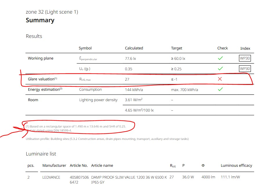

I search for a solution and i find that Displaying the calculation area is possible. if we check "Unified Glare Rating (Rug)" (see photo below).
The problem is that the the target value of outdoor glare limititation/valuation is defined by default to -1.
I tried to change the target value in properties but unfortunately nothing happened.
The thing that i'm searching is can we change the value target of glare limitation in outdoor lighting ?
