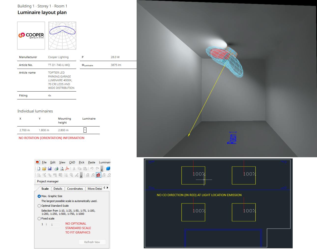

Hi, I hope you can help with this:
1.       As an installer I need to aim luminaires as software does but, in the report, (luminaire layout plan) EVO does not show aiming points or luminaire’s rotation angles. On report EVO shows only position but it doesn’t show rotation (orientation) of luminaires. For installation it is hard to aim lighting fixtures.
2.       Looking exported DWG file information, I don’t see anything that shows CO direction at light emission locations. This function is useful to check the correct orientation of the luminaires for installation. When it is necessary to deliver a luminaire layout drawing with specific luminaire orientation, you must manually draw all those lines in the DWG file, which is an activity that takes a lot of time. It is an extra time-consuming task.
3.       Sometimes reports’ graphics are very tiny, and information does not look good but there is not an option to change the scale of the graphic (I think, the largest scale is automatically used). It will be a good option to let the user choose an optimal standard scale (like DIALux 4.13).
Regards
