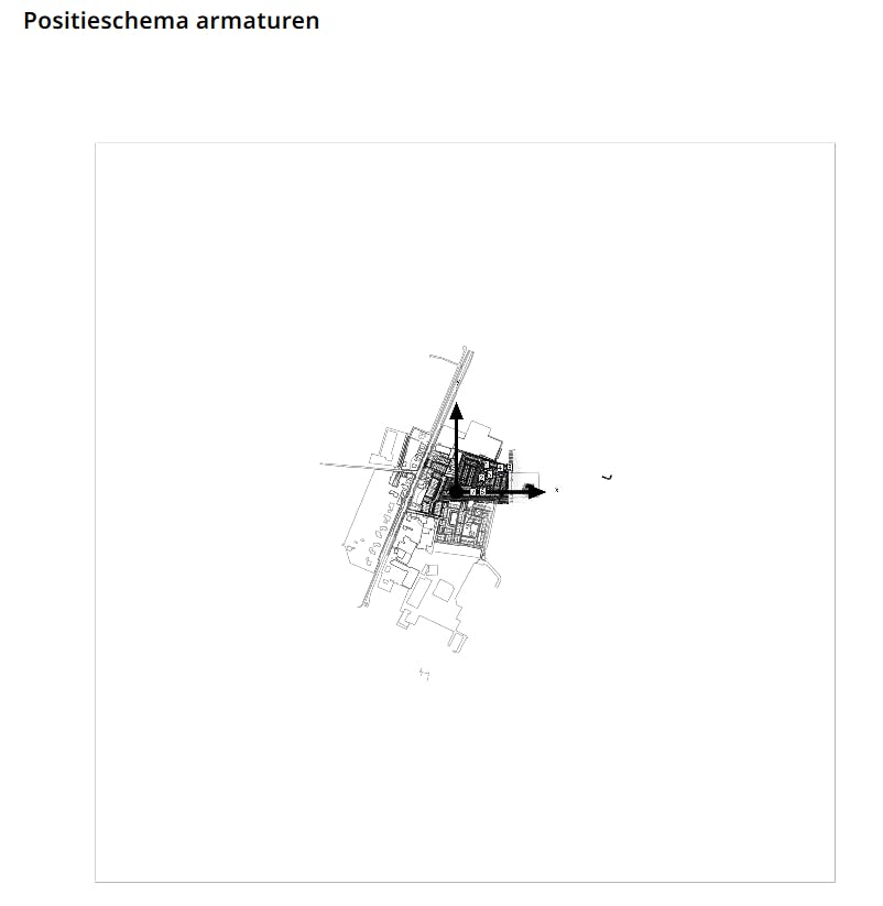

Print-out very small
13
Dell PC with Ultra 5 processor
Once someone showed me how to get a larger picture (don't remember how he dit it)
I would like to see the position of the luminaire-poles
anybody can give me a step by step way to zoom into this very compacted picture and displat THAT in my report ?

Best reply by Ferenc
try to reduce the size of the floor element (outdoor floor element)
