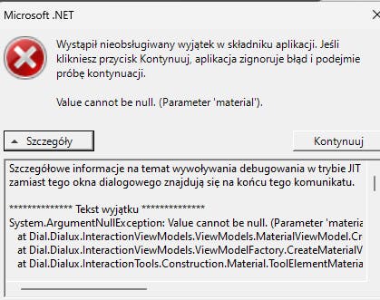

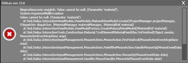

When trying to use option "Draw reflectance factor on surface", and accidently clicking anywhere beyond the surface - Dialux is getting error like this ๐Ÿ‘
or this
and sometimes even crashes totally.
I have Microsoft.NET updated.
I know that missclicking surface is my fault :D , but it shouldnt kill the program ๐Ÿ˜ฎ
Best reply by Kolja
We just released patch 2 which fixes the issue.
