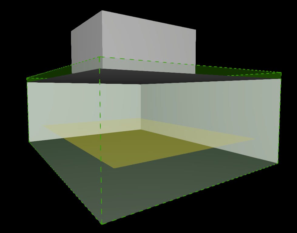

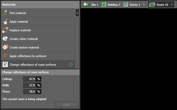

So sometimes, Dialux is picking up information on reflectance factors from somewhere else than the room. This has been around for some time.
It seems that when you create a new room, sometimes Dialux makes the space higher than the room, which causes it to pick up data from another floor? Same principle also applies when adding building openings, it can sometimes show reflectance factors like 59,6%.
How to recreate the bug:
  1. Create some rooms.
  2. Create a second floor and draw some rooms.
  3. Go back to first floor and draw a new room.
  4. Realize that the reflectance factors are off.. At least in the documentation. In the model it seems that when I click on the different surfaces everything is ok.
Hopefully my text makes sense. Otherwise let me know and i'll try to explain even better.
