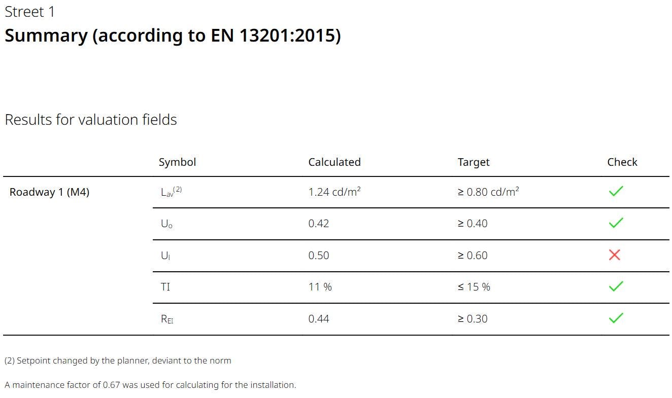

Hi! What does UI and REI stand for? Please see attached for reference.
I am also trying to find the Surrounding Ratio in my calculation, how can I locate or show that?
