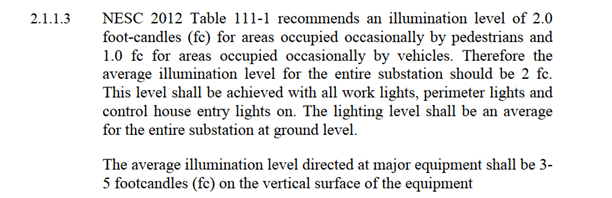

1. Is it necessary to model every piece of equipment and every bus by object while conducting the illumination analysis for the outdoor substation?
2. Should the measurements of the lighting ies be altered during import if they differ from the catalogue dimensions?
3. Coould someone review the dialux model & confirm the approach of the illumination study is correct for the outdoor substation.
4. What is the number of calculation profiles that need to be drawn for the requirement below? Kindly provide the instructions. The Dialux file is enclosed.
