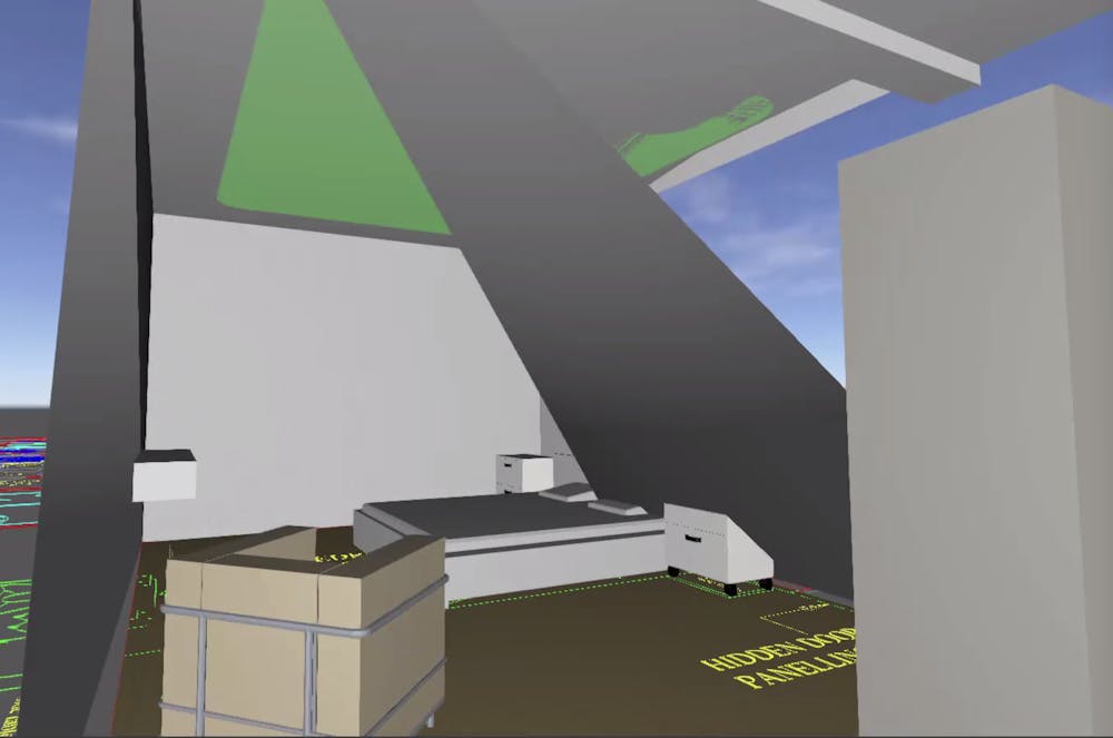

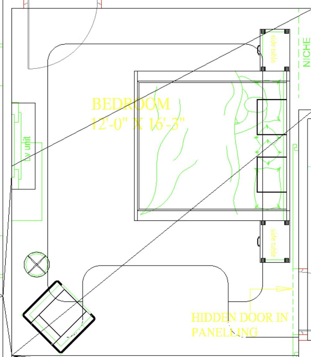

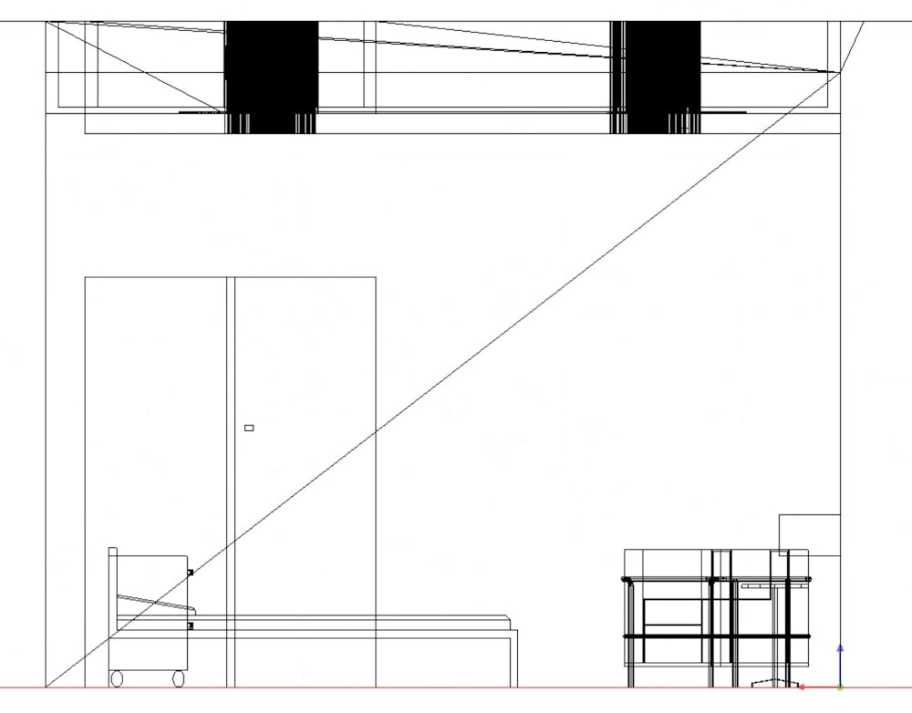

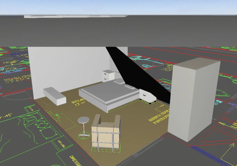

I am currently involved in a project of intricate nature, involving complex ceiling levels. Upon performing a cutout of a certain ceiling area, unexpected anomalies have been observed with regards to the building geometry. Specifically, walls have become imperceptible or are visible from only one perspective while being invisible from others. Moreover, the color of walls has transformed to a shade of grey or black, and peculiar diagonal lines have surfaced in the top plane that do not correspond to any meaningful aspect of the building.
Despite my attempts to rectify the issue, including restarting the system and modifying the wall geometry, the problem remains unresolved. At this point, I am seeking input from others who may possess insight into a potential solution. Does anyone have any suggestions?

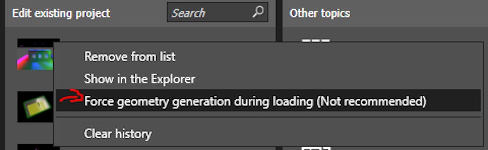

with evo 11.1 you can try to fix the problem by right clicking on the project on the start screen and select "Force geometry generation during loading (Not recommended)". This will discard the saved goemetry and create a new version. With a more complex project the loading time might increase noticeably.
