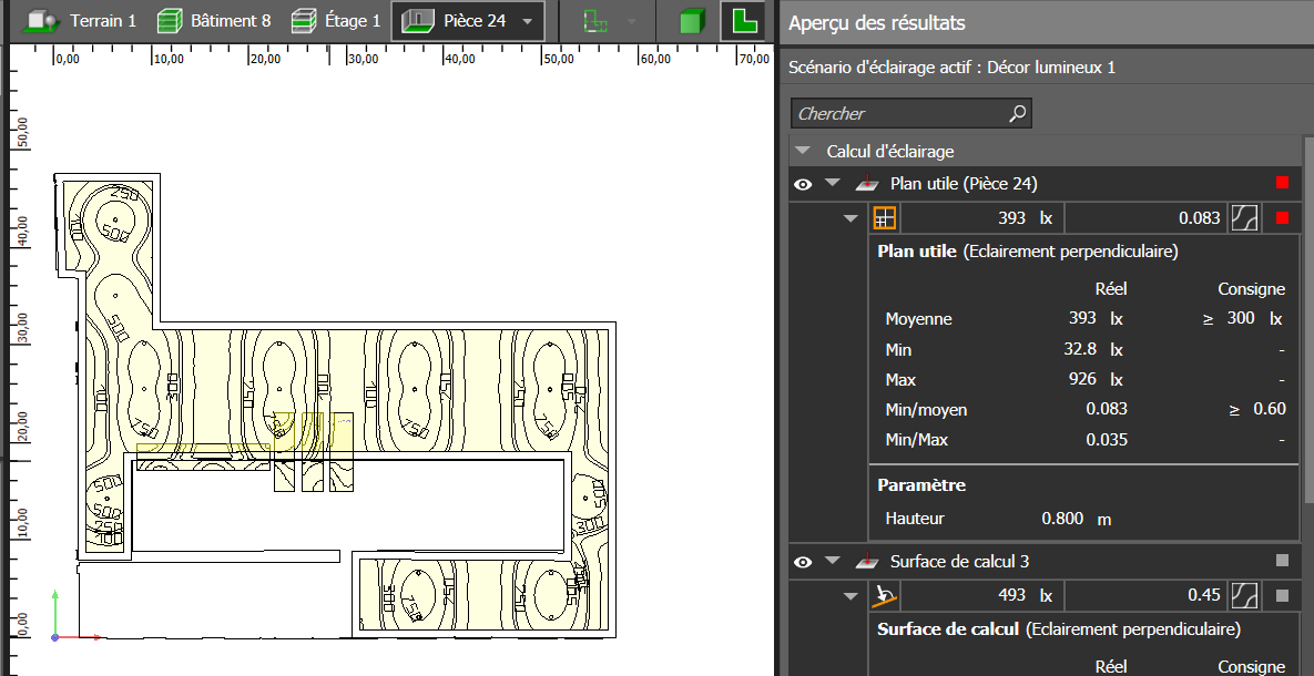

I have a problem of uniformity for my project, in fact it is a factory with a height of 9m, I chose 200W and 30000LM industrial fittings, the number of lux is respected but the uniformity is very low, how can I solve the problem of uniformity (see image below).
