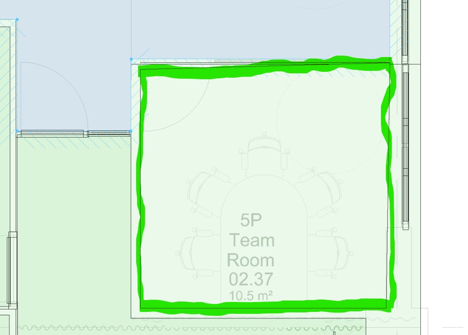

A ghost room is created by Dialux which cannot be accessed or selected to be able to delete. As per green border below. The walls appear transparent in 3D. I need this deleted.
Best reply by Kolja
Just right click on the project on the start screen and select "Force geometry generation during loading". This will fix the problem.
