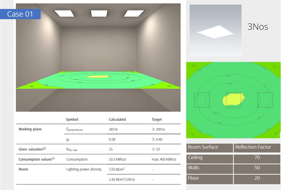

The goal of the lighting designer is to optimize the lighting design of a given space while minimizing energy consumption. In Case 01, I applied a 70/50/20 rule for ceiling, wall, and floor reflectance and achieved an average illuminance of 383lx with a uniformity of 0.58.

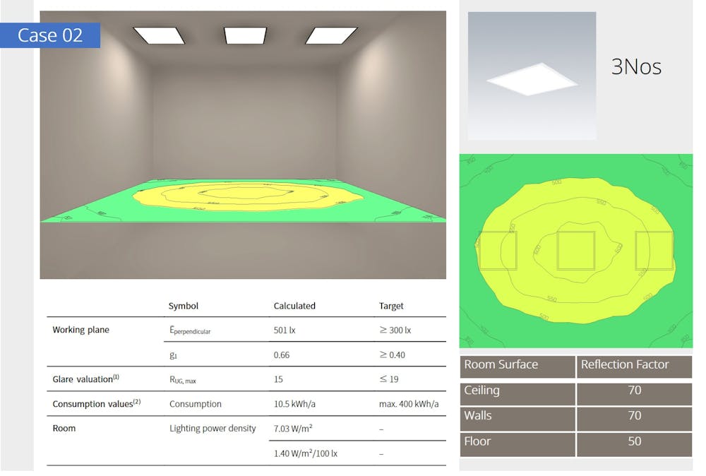

In Case 02, I used materials with reflectance factors of 70 for both ceiling and wall and 50 for floor (as proposed by the ID) and obtained an average illuminance of 501lx with a uniformity of 0.66. However, this level of illuminance exceeded the required standards for the space.

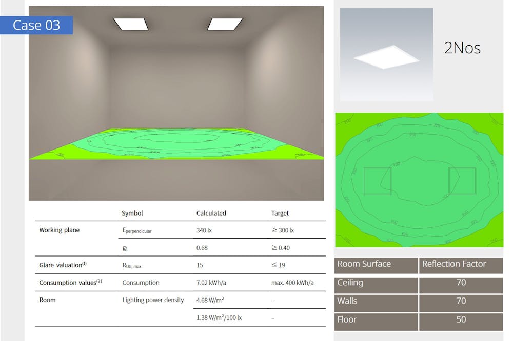

Consequently, in Case 03, I rearranged the luminaires, reducing their number from three to two and achieved an average illuminance of 340lx with a uniformity of 0.68. This resulted in a significant decrease in energy consumption, from 10.5kWh/a in Case 01 to 7.02kWh/a in Case 03.
(That is a reduction of 33% in energy consumption between Case 01 and Case 03)
