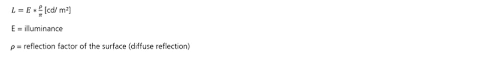

Luminance has something to do with the reflection factor of a surface in combination with the illuminance level. If the surface has a high reflection factor, it appears much brighter under the same illuminance than a surface with a low reflection factor.
There is a simple formular which shows the relationship between illuminance and luminance:
It seems trivial, but often this fact is disregarded and planning is reduced only on the value of illuminance.
For example, a dull dark grey wall that is intended to achieve a guiding effect should be brightly lit. You don't have to be an expert to realise that there is a conflict of objectives. Of course, technically it is possible to generate a few thousand lux on that wall, but due to the low degree of reflection (diffuse reflection), the wall remains quite dark in perception.
It would be much more efficient (and energy-saving by the way) to work with a lower illuminance level and a higher reflection factor (i.e. white or at least a light colour). Unfortunately, as a lighting designer you rarely have any influence on the colour scheme in the room. So, this leaves only the "crutch" of dimensioning via illuminance.
