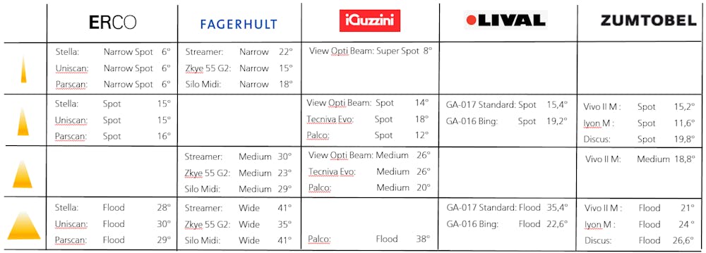

Luminaires that produce the focused light are often called spotlights. To ensure that we can quickly and easily find a product with a specific beam angle, it is important that manufacturers always tell us the corresponding light distribution. This is very often done by using terms such as: Super Spot, Spot, Medium Flood, Flood, Wide Flood, etc.
But what exactly do these individual terms stand for? We have noted that the beam angles of the luminaires within a designation can be widely different. At the time of our research, the beam angle for luminaires with the designation "Spot" was between 12° and 19.8°. For luminaires with the designation "Medium Flood", the deviations were even up to more than 10°. This makes our product selection much more difficult and time consuming when we are looking for a luminaire with a very specific beam angle.
The following table provides an insight into our research and makes it clear: The designation "Spot", "Flood", "Wide Flood" alone says nothing about the beam angle! The number of degrees is decisive!

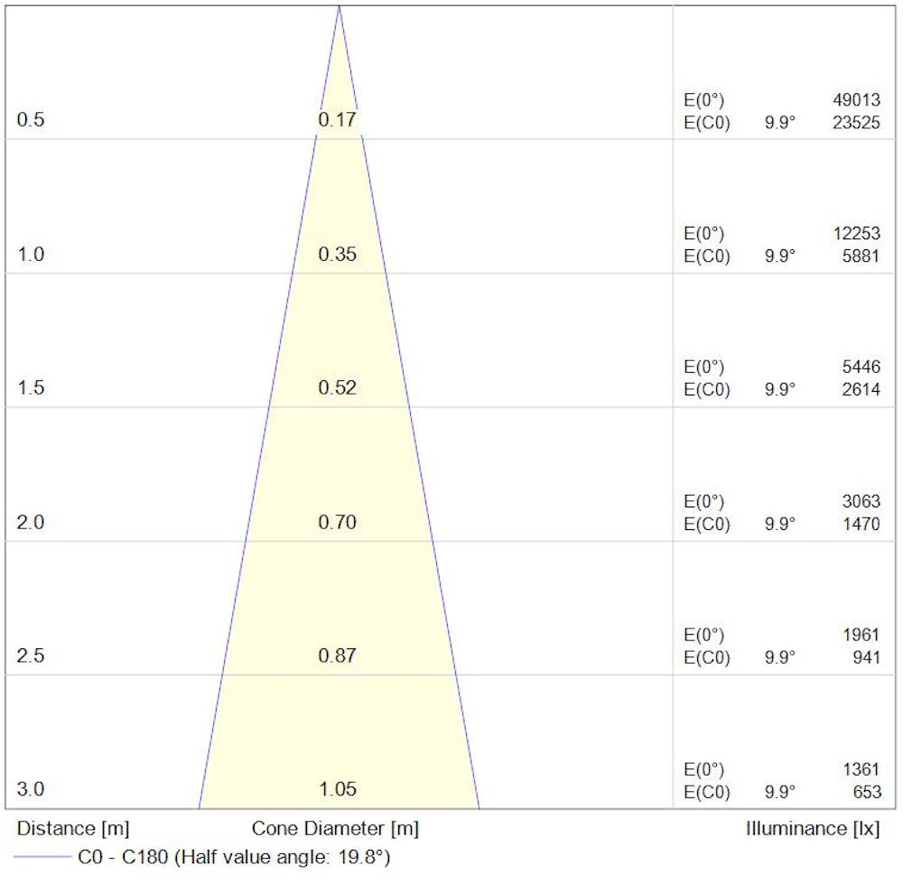

If the beam angle is only described verbally, a look at the cone diagram will help. Here, the beam angle is always specified. If the luminaire data sheet does not have a cone diagram, the luminaire file can also be imported into the LDT Editor or DIALux. Here, the cone diagram can be viewed in each case.
