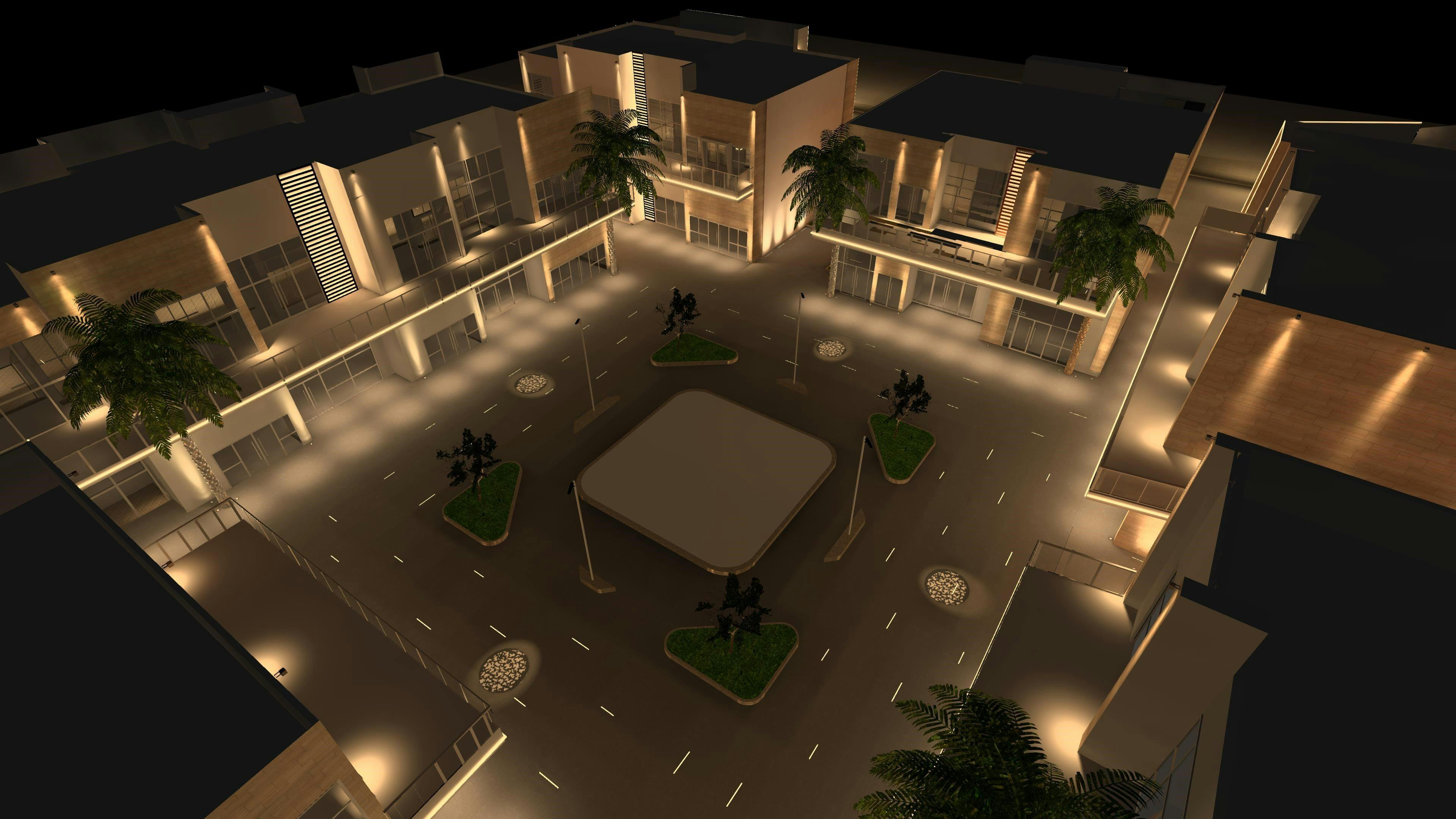

In the image provided, the landscape lighting design effectively enhances both the natural and architectural elements of the space, creating a visually appealing and functional outdoor environment. Here’s a detailed breakdown of the lighting techniques and products used:

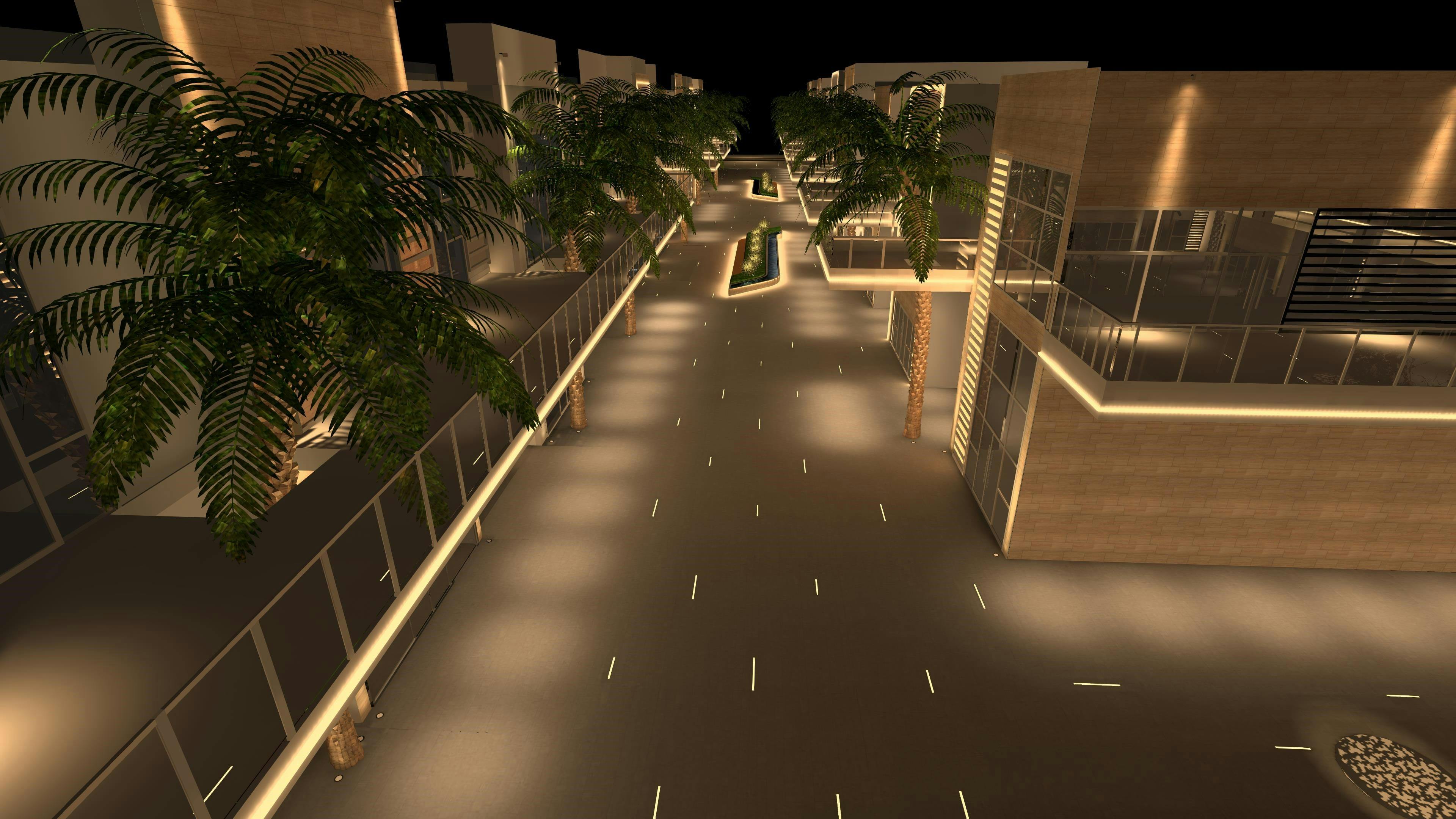

1. Walk-Over Linear Lights
  • Product Type: Walk-over linear LED lights
  • Placement: These linear lights are embedded into the ground along the pathways. They provide a subtle guide for pedestrians, creating a rhythmic pattern of light along the walkway.
  • Function: The lights help delineate the path, providing safety and direction without overpowering the surrounding environment. The linear form factor ensures even distribution of light across the walkway.
2. Uplights for Plantation
  • Product Type: In-ground or surface-mounted LED uplights
  • Placement: These lights are installed at the base of the palm trees and other significant plants. The uplights are aimed upward to illuminate the foliage and trunks of the trees.
  • Function: Uplighting the trees accentuates their height and form, creating dramatic shadows and highlights. This technique adds depth and interest to the landscape, making the trees stand out as focal points in the overall design.
3. Neon Strip Lights for Architectural Structure (Balcony)
  • Product Type: LED neon strip lights
  • Placement: Neon strip lights are installed along the edges of the balconies and architectural structures. They run continuously along the perimeter, highlighting the building’s form and adding a modern touch to the design.
  • Function: The neon strip lights outline the building’s balconies, creating a clean and contemporary aesthetic. They also enhance the architectural details of the structure, making the building more visually striking at night.
4. General Ambient Lighting
  • Product Type: Downlights and recessed fixtures
  • Placement: Positioned under the overhangs, canopies, and other architectural features, these lights provide general illumination to the surrounding area.
  • Function: This ambient lighting ensures that the entire area is well-lit without any harsh contrasts or dark spots. It creates a welcoming and comfortable atmosphere for pedestrians and visitors.

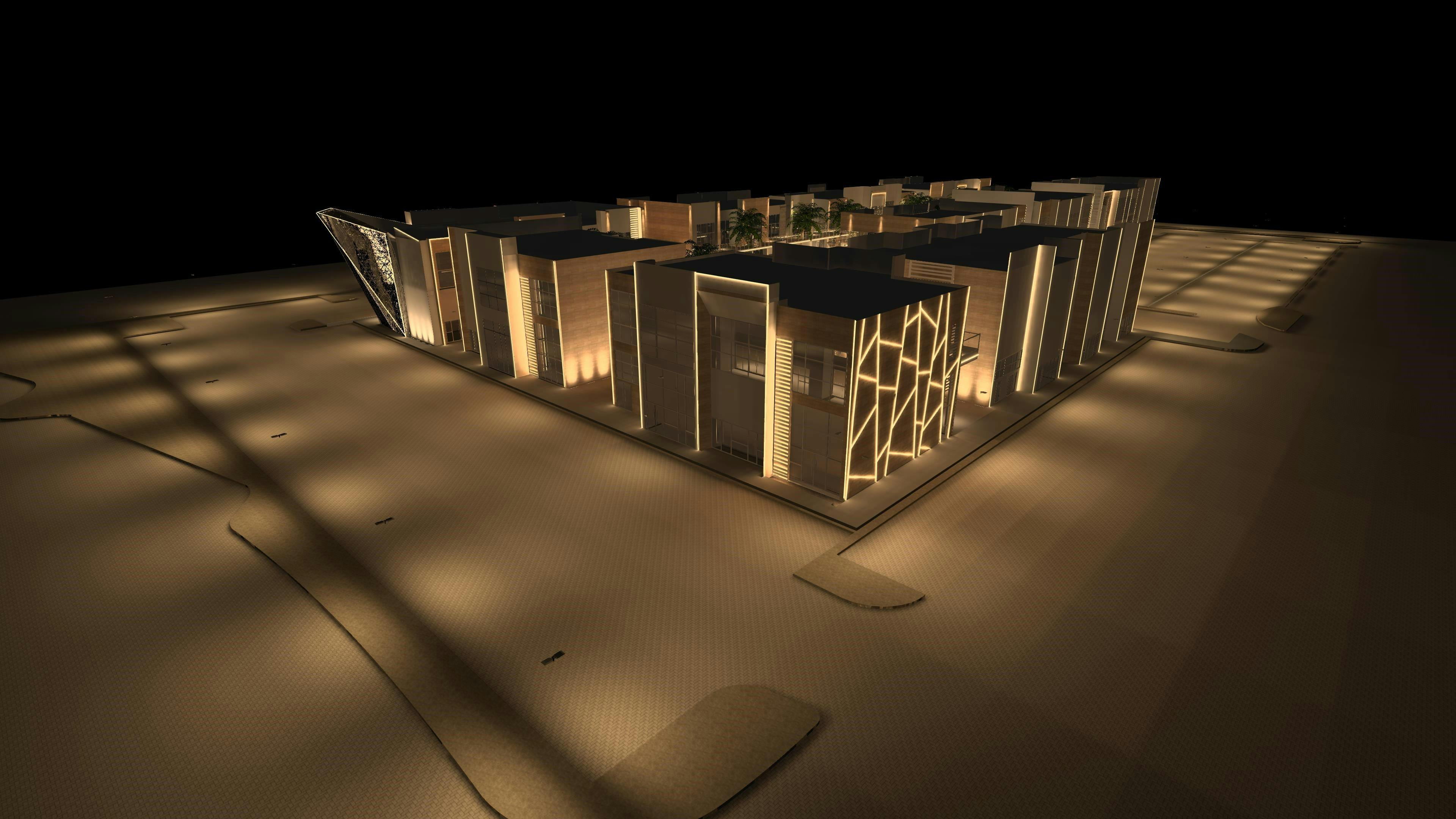

    1. Linear Recessed Profile Lighting:
      • Application: Used to highlight the vertical and horizontal lines of the building facade.
      • Product: Recessed linear LED profiles are embedded within the architectural elements of the facade. These profiles are designed to be slim and discreet, providing a continuous line of light that accentuates the building's structure.
      • Effect: The linear lighting creates a clean, modern aesthetic, emphasizing the geometry of the facade and enhancing the building's night-time appearance. The light subtly grazes the surface, highlighting the textures and materials.
    2. Geometric Linear Profile Lighting:
      • Application: Applied in a pattern that complements the architectural design, often in a geometric arrangement across the facade.
      • Product: LED linear profiles installed in a geometric pattern, which could include zig-zag, diagonal, or other angular designs.
      • Effect: This lighting technique adds visual interest and a dynamic element to the facade, making it a focal point. The geometric patterns are illuminated, creating a striking visual contrast against the darker elements of the building.
    3. Wall Washer Lighting:
      • Application: Used to illuminate large sections of the facade evenly.
      • Product: Wall washer fixtures are typically installed at the base or top of the facade, depending on the desired effect.
      • Effect: This lighting creates an even, soft glow across the facade, ensuring the entire surface is well-lit without harsh shadows. It enhances the overall visibility of the building and can be used to highlight specific textures or materials used in the construction.

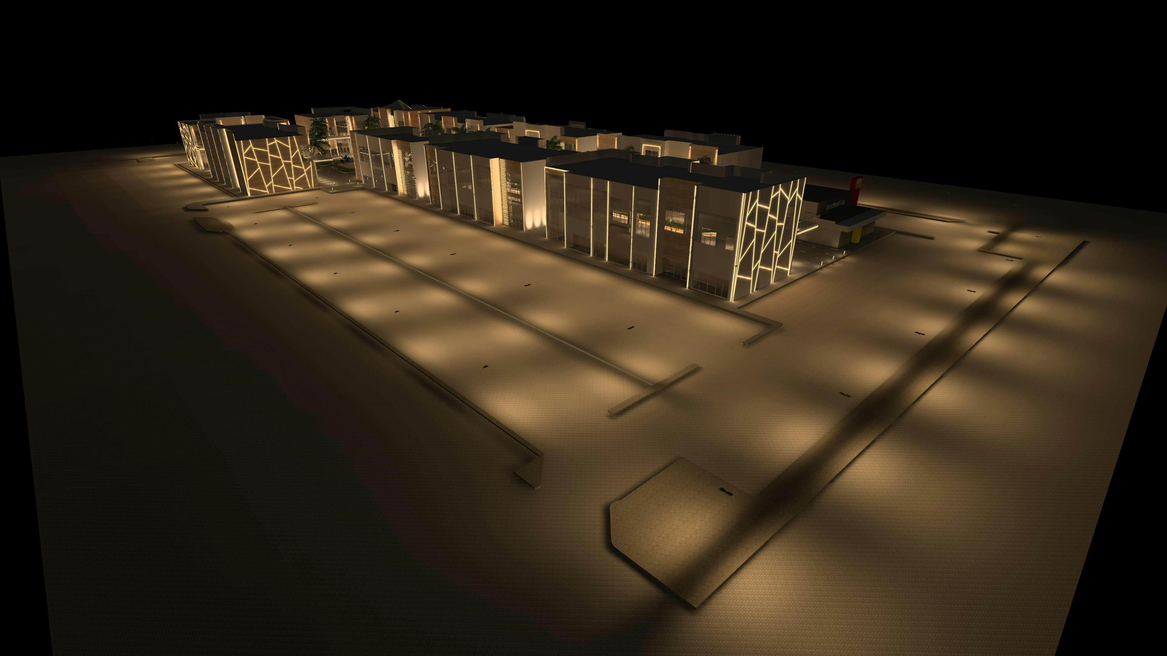

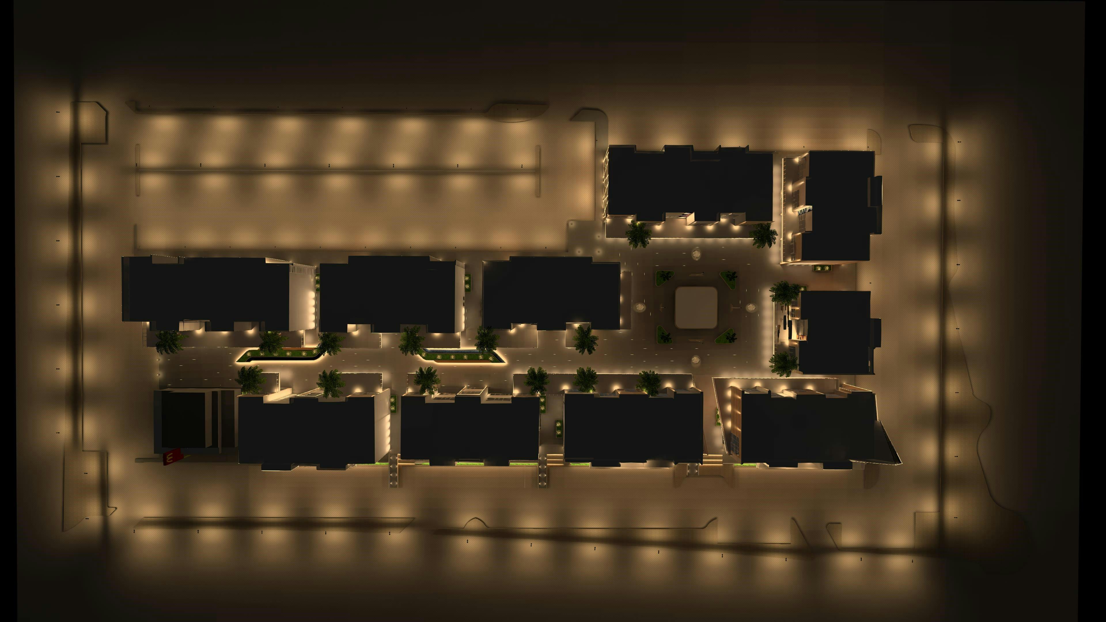

    Parking Lighting Design Explanation
    • Lighting Layout: The parking area is illuminated using evenly spaced lighting fixtures to ensure uniform light distribution.
    • Product: High-efficiency LED fixtures are used, typically pole-mounted or bollard lights, to provide adequate illumination for safety and visibility.
    • Effect: The lighting ensures that the parking area is well-lit, with minimal glare and shadowing, improving both the aesthetic appeal and functionality of the space.

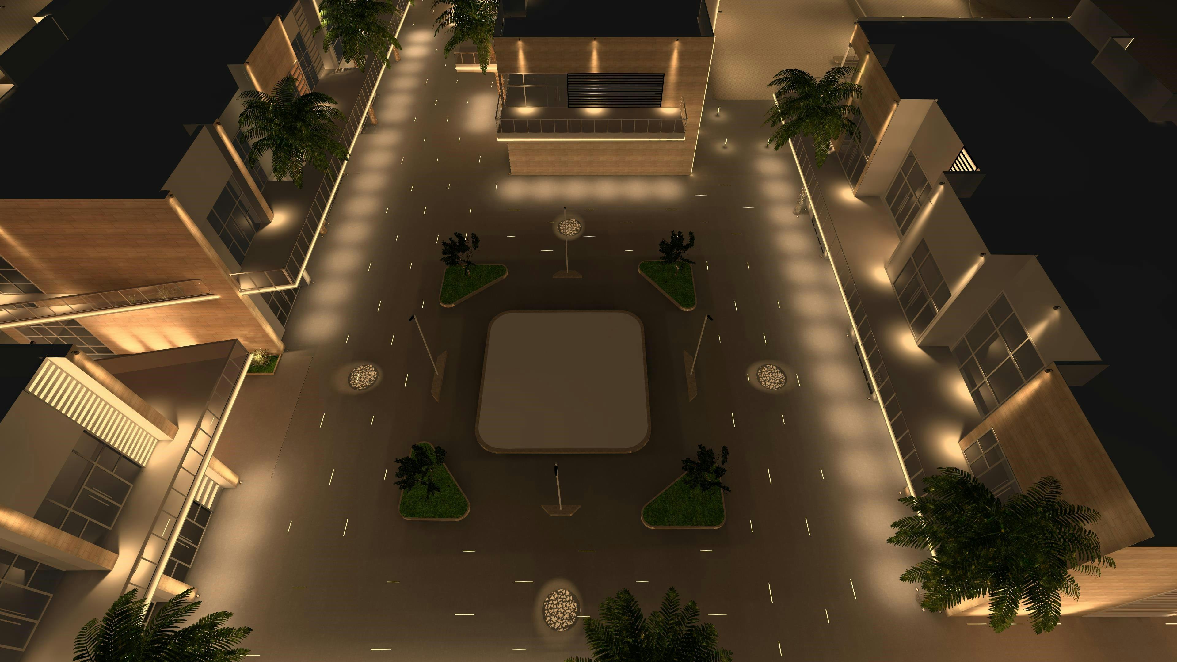

Integration and Overall Impact
The combination of these lighting techniques creates a cohesive and inviting outdoor space. The walk-over linear lights guide movement, the uplights enhance the natural beauty of the plantation, and the neon strip lights accentuate the architectural features. Together, these elements provide both functional lighting and aesthetic appeal, ensuring that the landscape is as impressive at night as it is during the day.
This thoughtful approach to landscape lighting not only highlights key features but also enhances the overall ambiance of the space, making it a pleasant environment for users. The use of energy-efficient LED technology also ensures sustainability and long-term durability of the lighting system.
