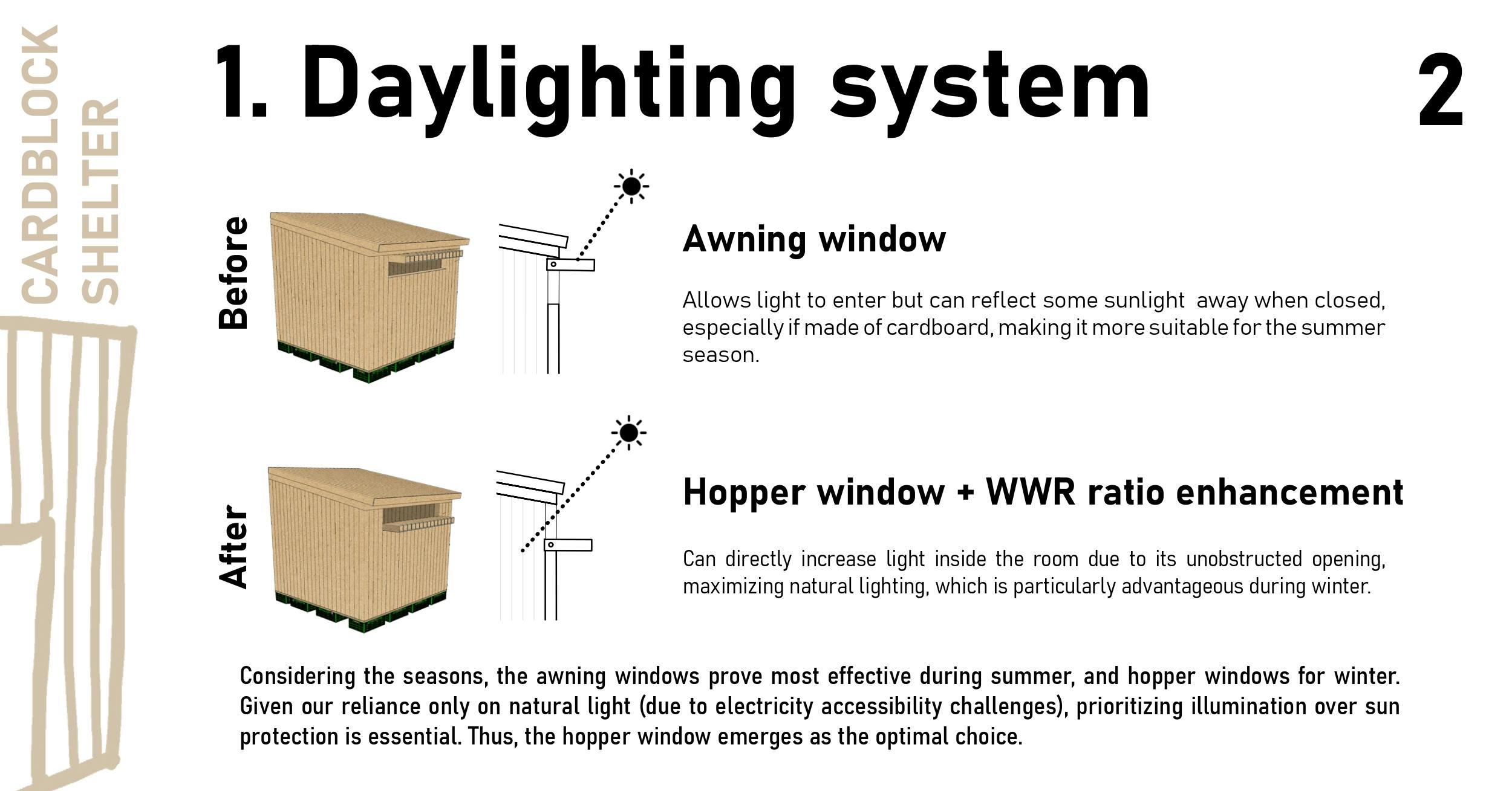

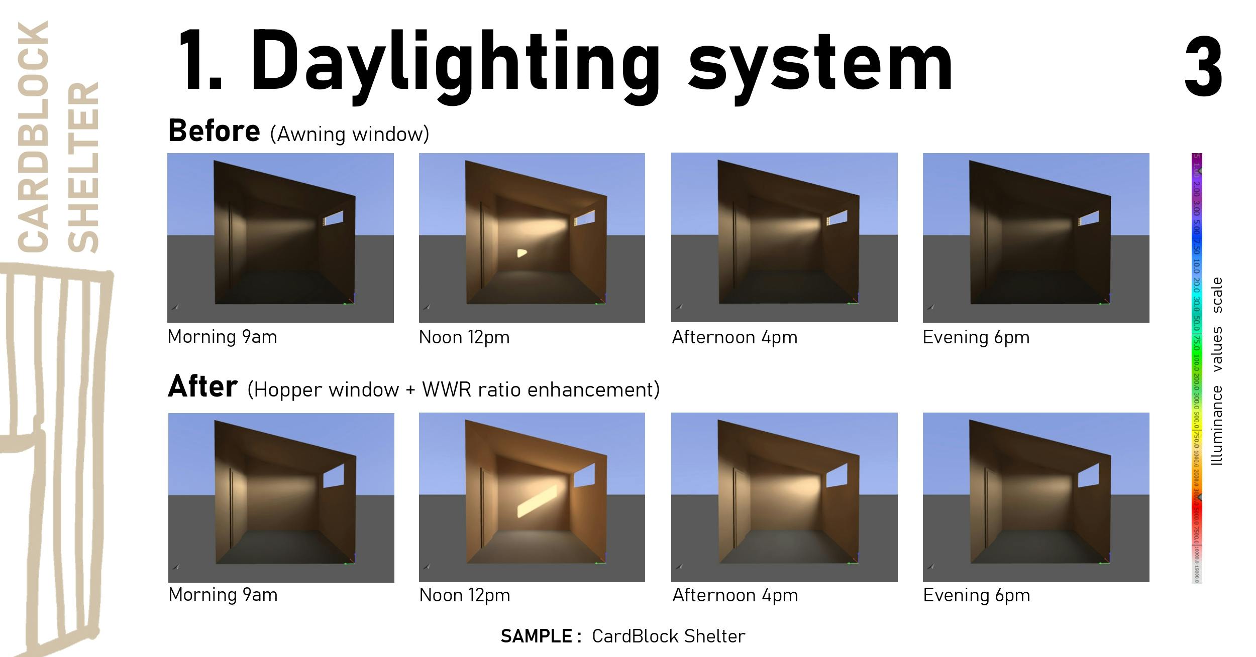

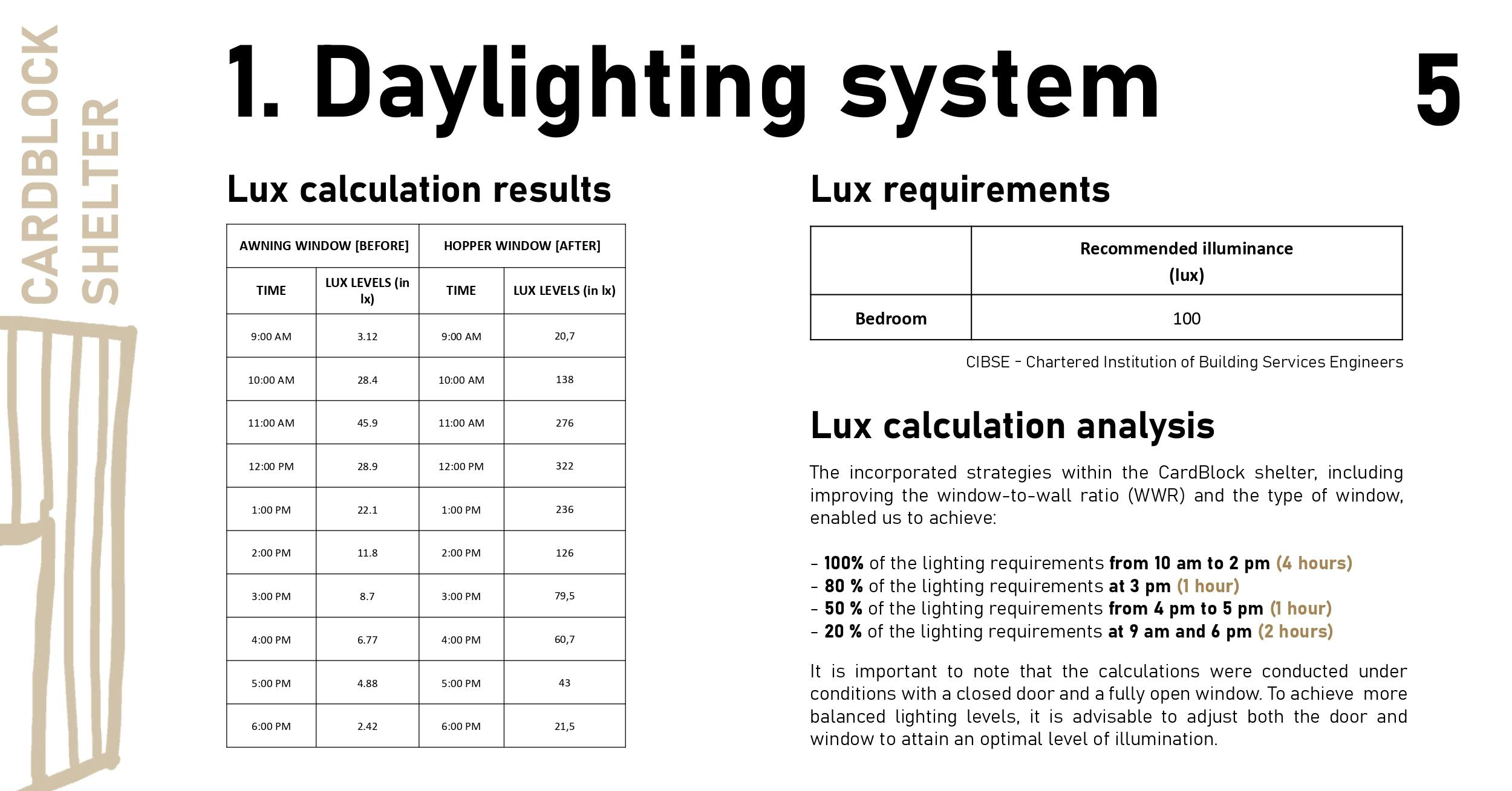

We conducted lux calculations using Dialux Evo from 9 am to 6 pm, guiding our strategies. Initially, our shelter prototype provided 28.9 lux at noon. Through strategic enhancements like adjusting the Window-to-Wall Ratio (WWR) and incorporating specific window types, we achieved an impressive 322 lux at noon, meeting lighting standards effectively.

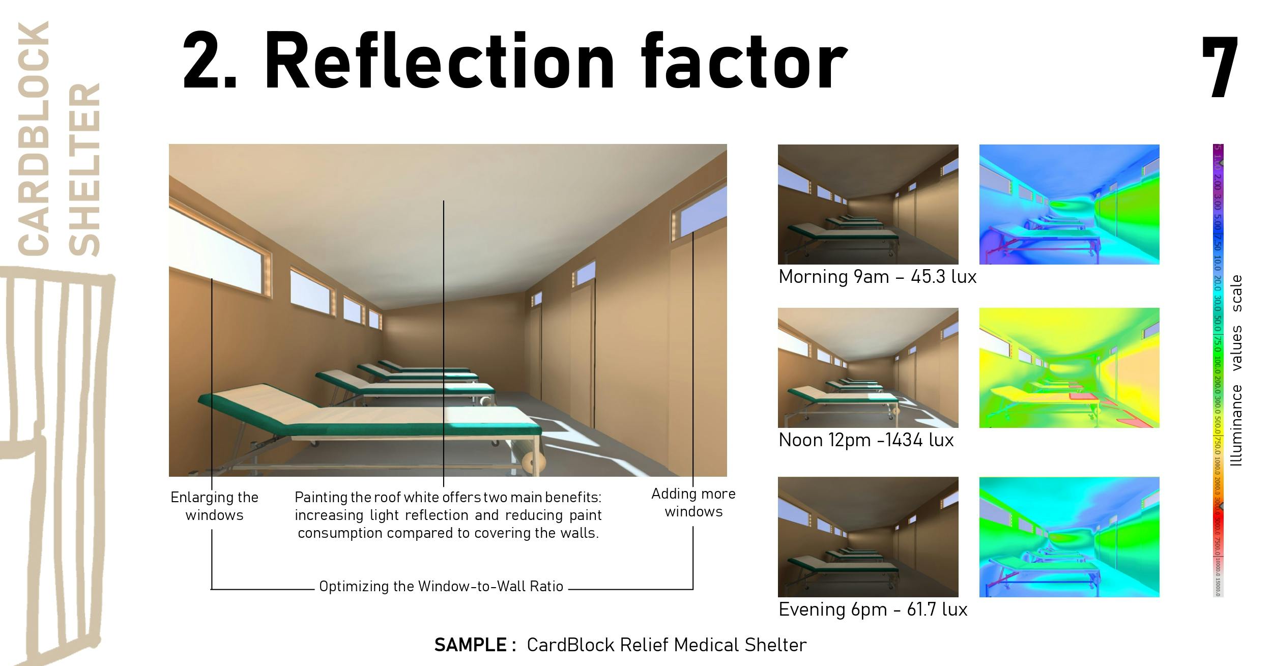

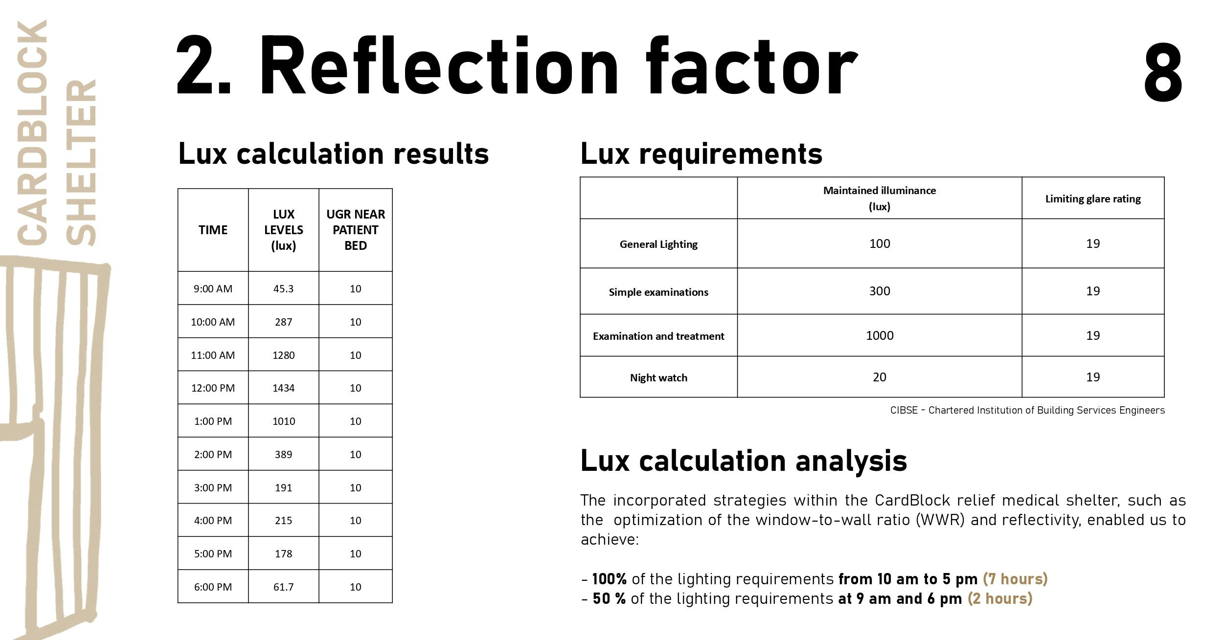

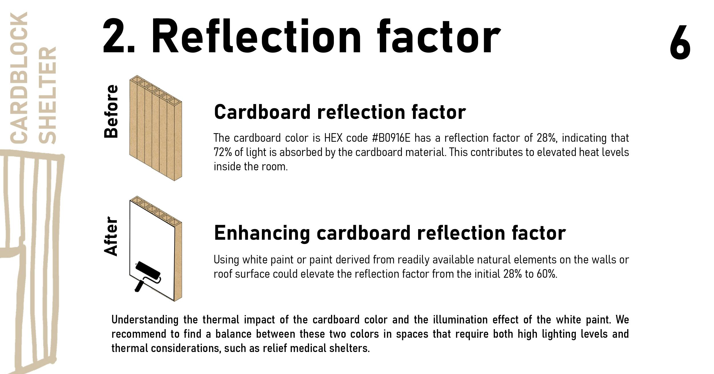

For emergency hospitals within these shelters, our goal was to ensure sufficient lighting levels for medical examinations and treatments. By fine-tuning our daylight strategies, including enhancing the reflection factor of surfaces using eco-friendly paint, we achieved the required lux solely with natural light.
Additionally, we strategically placed additional small windows to capture sunlight during sunset hours, ensuring consistent illumination throughout the day.
