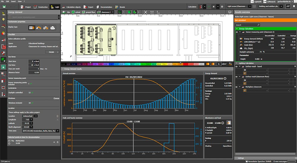

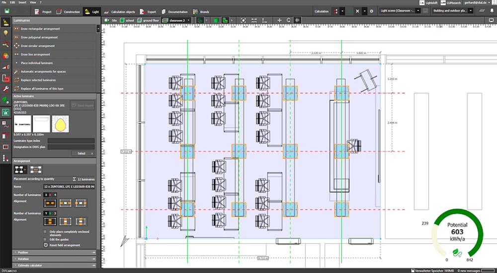

From this version on, it is easy to calculate the energy demand and the saving potential of a lighting system with daylight control in passing.
When you place a luminaire an energy tachometer is displayed showing the current energy demand and the estimated saving potential. The estimation is done with the help of the old EN 18599 method. The energy tachometer can be deactivated in the settings. A click on the speedometer opens the new energy saving tool.

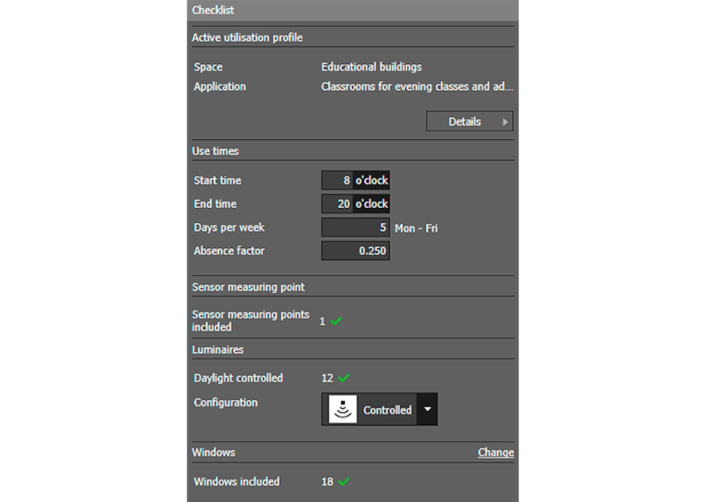

In the new energy saving tool, all information of the usage profile necessary for the energy calculation is displayed. The sensor measuring point can also be placed here. Only one sensor measuring point is allowed per room/area. A checklist in the tool indicates whether the prerequisites for a daylight-controlled lighting system are met (e.g. windows).

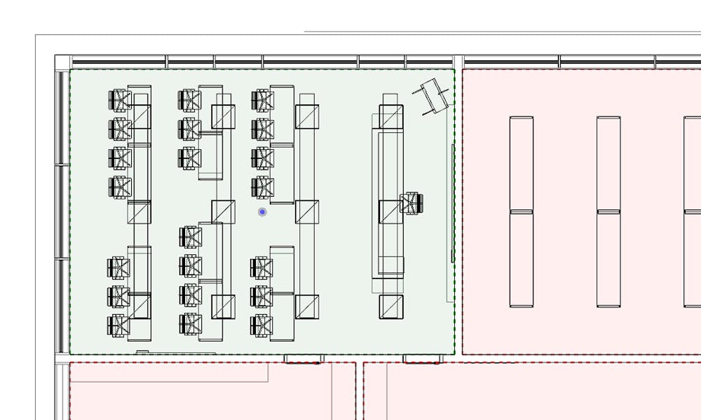

In the floor overview, rooms with sensor measuring point are displayed in green, those without sensor measuring point in red.

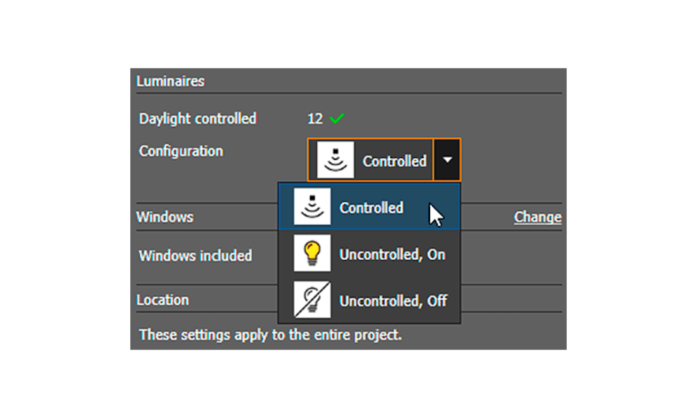

For each luminaire it can be specified whether it is daylight controlled, constantly switched on or constantly switched off.

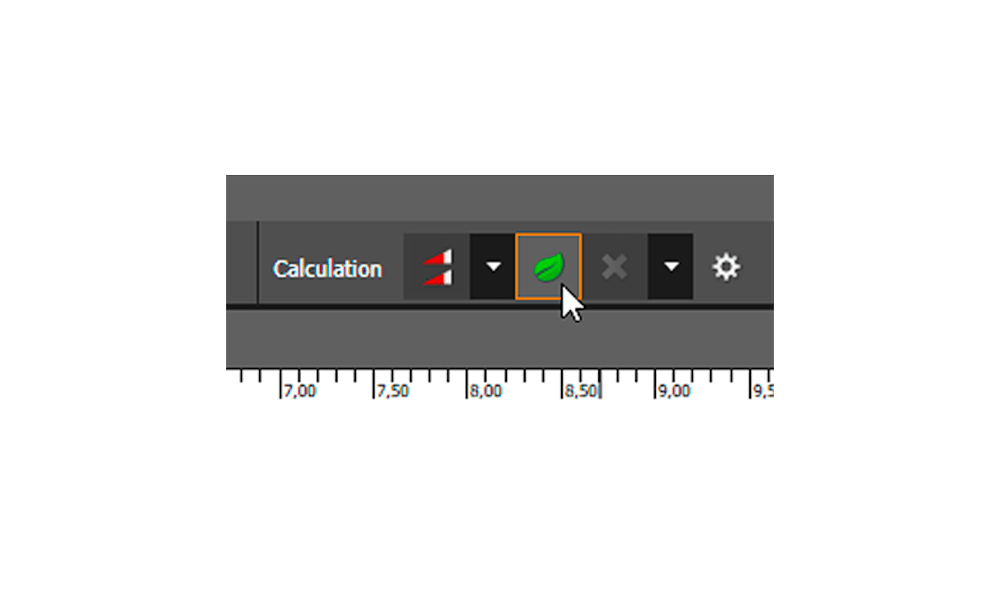

The start of the energy calculation is done via the button above the CAD. The calculation is based on an hourly calculation method, i.e. all 8760 hours of a year are calculated. The calculation is performed only for indoor rooms or areas. The room geometry, the building orientation and the position of the building are correctly taken into account.
The calculation uses the specified system power of the luminaires to determine the energy demand. For daylight controlled luminaires, a linear relationship between power and luminous flux in the dimmed state is assumed. Times of use are determined from the usage profiles of the areas. Switched-on luminaires that are explicitly excluded from control also take into account the specified times-of-use. The daylight control systems use a simplified control logic that closes them at a horizontal illuminance of 27,500lx. The calendar year 2022 is used as a reference. It is not a simulation of this year, the reference year is only used to assign the days of the week to the calculated results. The sky model used is the average sky described in CIE 110 without direct sunlight.

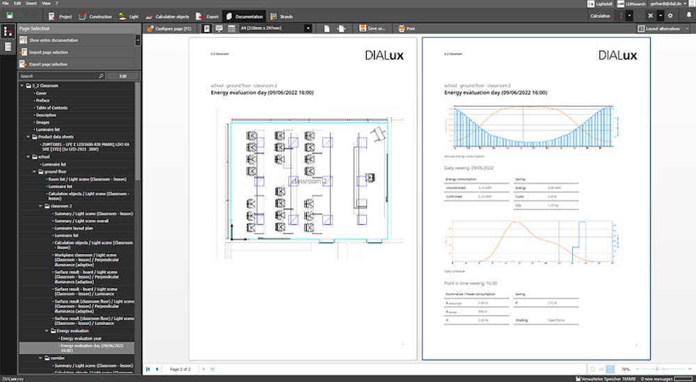

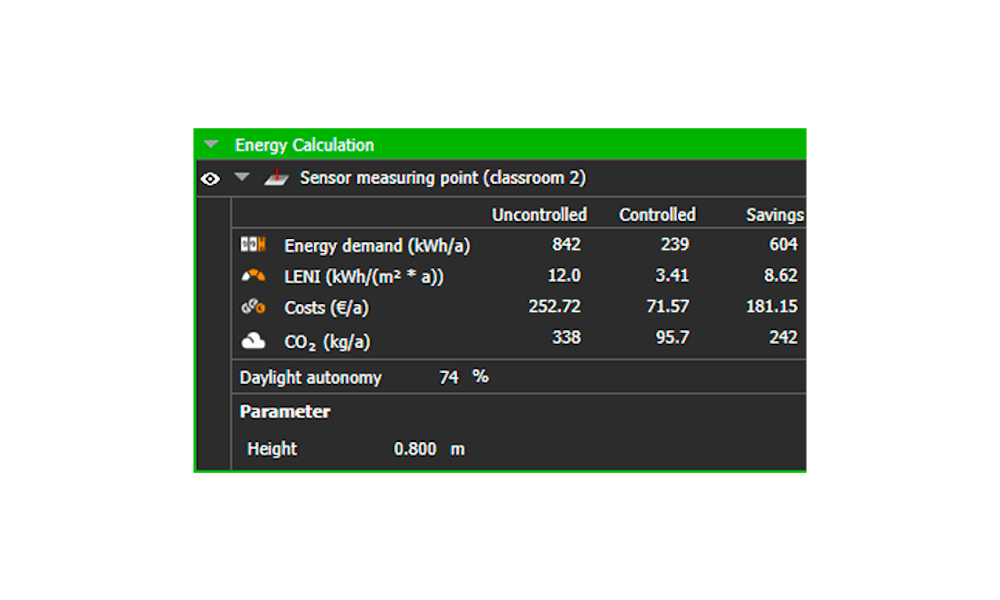

After the calculation, the annual energy demand, the Leni, the costs in Euro as well as the CO2 savings in kg are displayed in the result monitor. In addition, the energy saving tool shows the annual course of the daylight input in (lx h) and the energy demand of artificial lighting as a diagram. Within the annual diagram a single day can be selected with the help of the slider, on which in the second diagram the illuminance at the sensor measuring point is represented.
Via the button "Use in output" the currently selected point of time can be transferred to the documentation. All time points selected in this way are displayed in the tool and can also be removed.

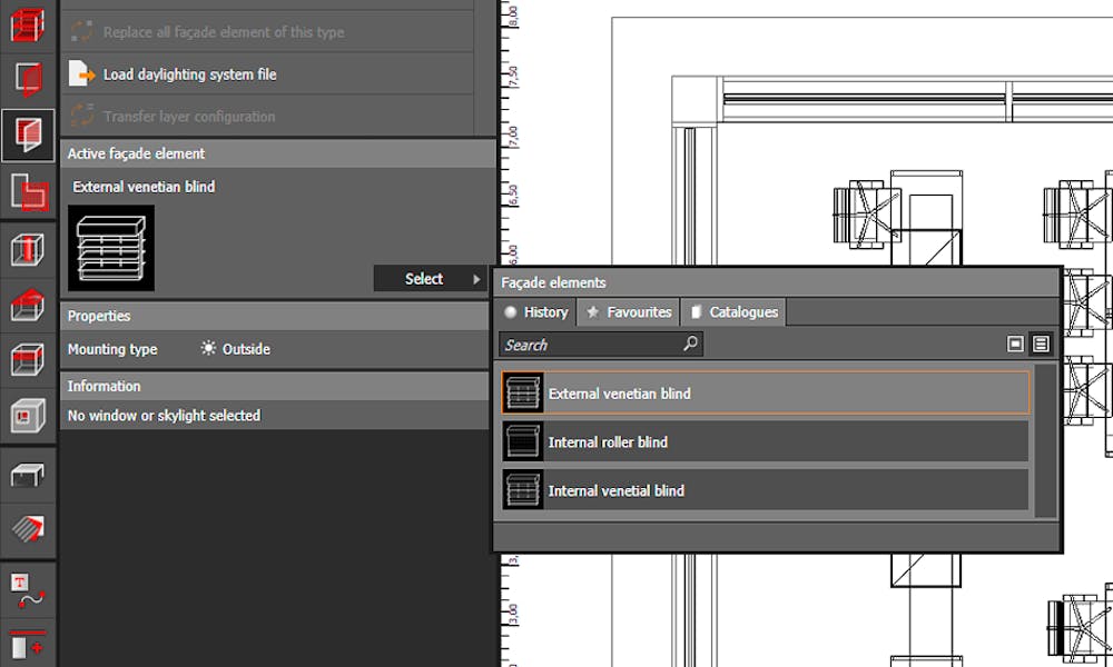

DIALux evo now offers a selection of generic facade systems.
Daylight autonomy: DIALux evo now displays the daylight autonomy after calculating the energy demand. This requires the placement of a sensor measuring point from the energy evaluation.

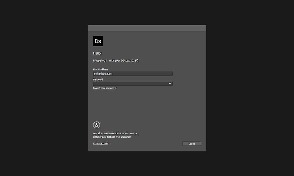

DIALux ID
Starting with DIALux evo 11, you need a user account to log in when starting the software, your DIALux ID. Registration is possible directly in DIALux. It is done rapidly and, of course, free of charge. With your DIALux ID, you will also be able to use other DIALux services in the future, such as the DIALux Community, our user support or Lightshift.
If you have already tested or subscribed to a DIALux Pro Feature or registered at my.dialux.com, you can continue to use these login credentials. They simply become your DIALux ID without you having to do anything.

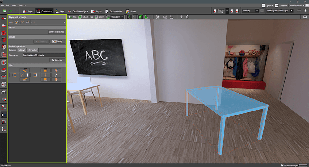

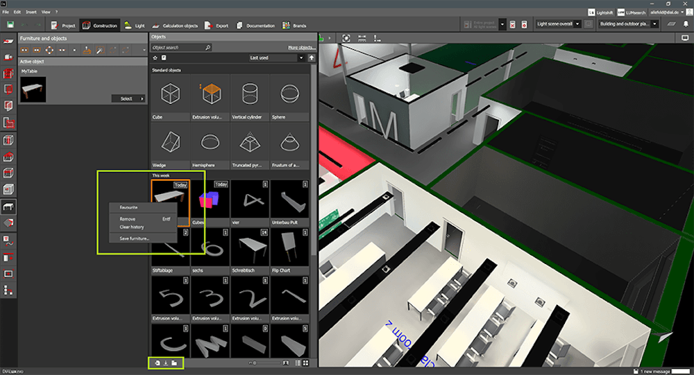

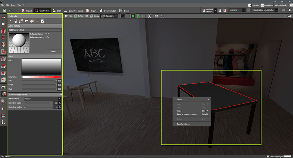

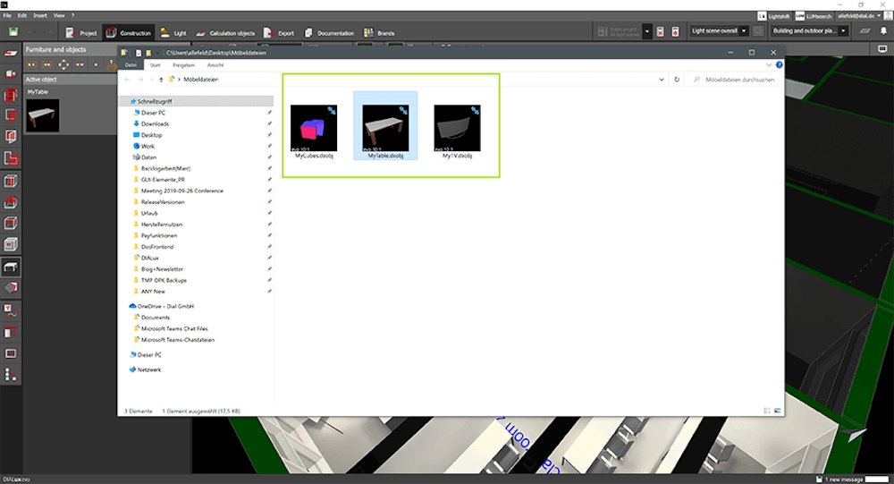

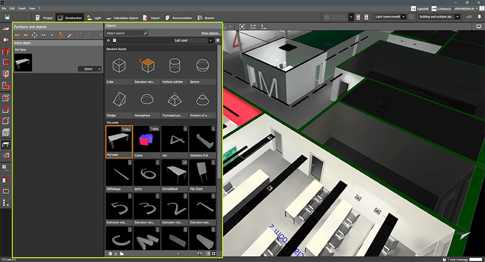

Save self-constructed furniture
With DIALux evo 11 you can save your self-constructed furniture or other objects in DIALux. The furniture files have their own file format and can also be exchanged with other DIALux users. That means they can only be imported and also saved in DIALux version 11 and higher.
The user interface of the furniture catalog has been adapted to that of the lighting catalog. There are now search and filter options. By right-clicking or using the actions in the footer, furniture can be loaded into or saved from the catalog.
In addition, you can save furniture by right-clicking from the "Materials" and "Copy and Arrange" tools. Before furniture can be saved in Copy and Arrange by right-clicking, the individual parts must be combined into a whole.

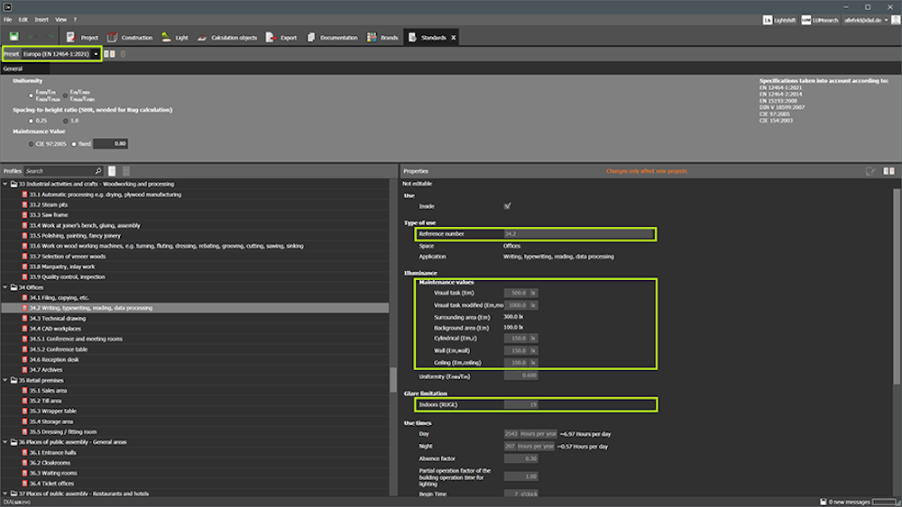

With DIALux evo 11 we have added the update for the latest version of EN 12464-1:2021-11 for you. You can still choose between the previous version from 2011 and the new one from 2021. Both versions work in parallel.
Database for profiles
The standards database has been extended by the tables from section 7. Four additional limit values have been added per entry. The missing reference numbers have been added and displayed.

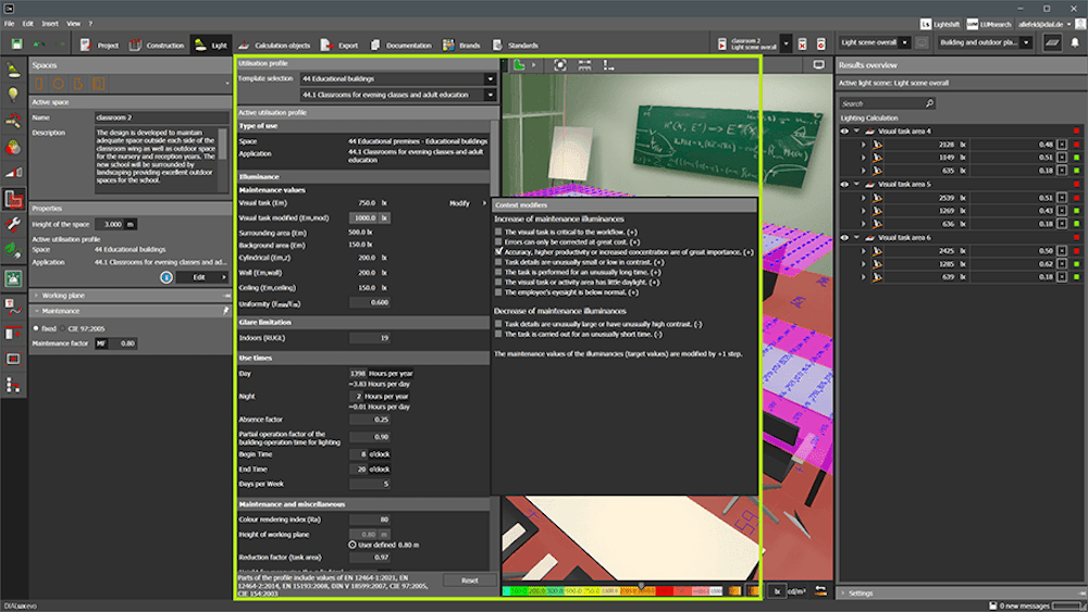

Profile selection
At the room (area) the usage profile is selected as usual. The topic normative settings is now visualized more clearly. The content is grouped thematically. The profiles are sorted by their reference numbers. This simplifies the selection. In addition, context modifiers can be specified on the profile. Their effects on the limit values (result overview) are displayed directly by DIALux.

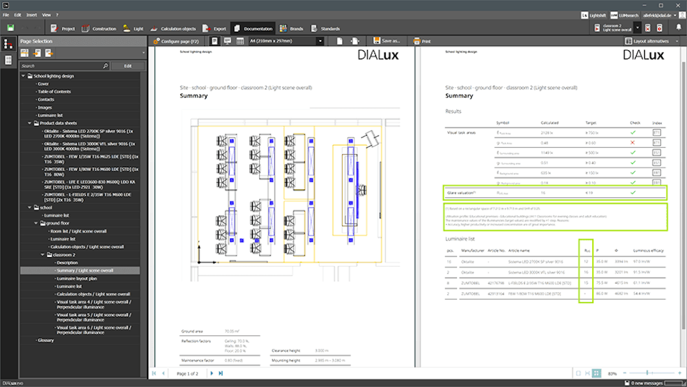

Glare for rooms (areas) is calculated according to the tabular procedure shown in CIE 117 and compared against the R(ugl), largest allowed glare.

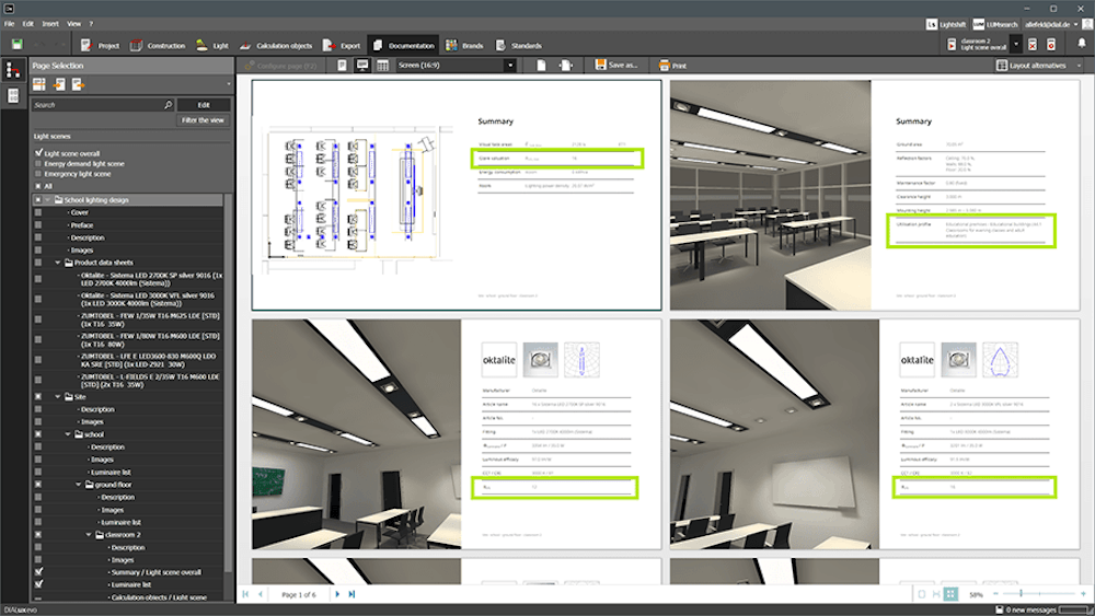

Documentation
On the room summary, the indication of glare according to CIE 117 and the context modifiers selected on the profile have been added. Especially for the table method, the size of the calculated space is documented again. Depending on the shape of the room, this can be larger than the room itself.

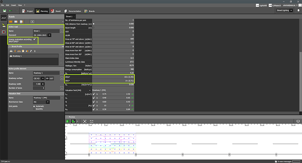

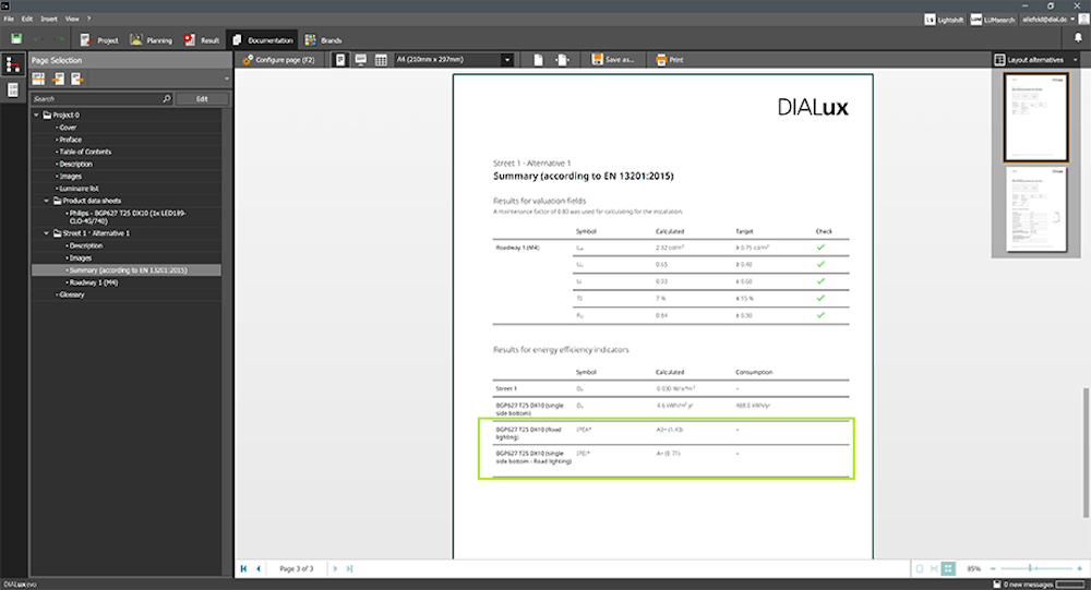

Italy follows EN 13201 for road design, but there are two additional ratings to be calculated compared to the energy efficiency indicators in Part 5 - IPEA* and IPEI*. These can now simply be added via checkbox. Of course, these values are also part of the documentation.

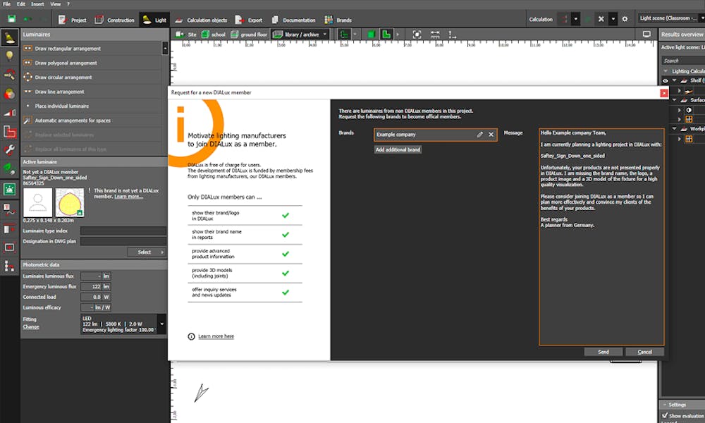

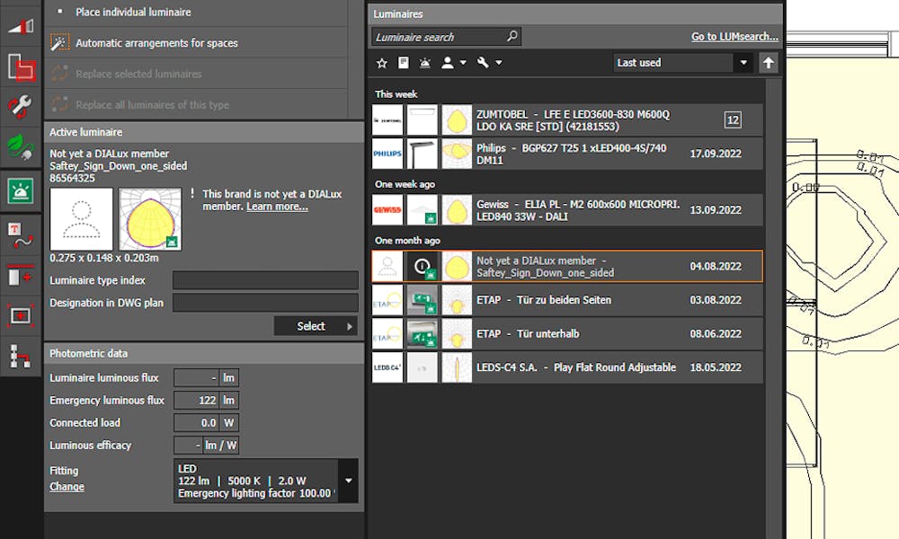

You can motivate non-members from within DIALux to sign up for DIALux membership. The message: I often plan with your luminaires in DIALux and have disadvantages as a planner due to your lack of membership. Why don't you become a DIALux Member so that I get the advantages of using your brand?
Once there is this possibility in the luminaire list for non-member luminaires.
Furthermore, the documentation also offers this possibility. DIALux determines here whether non-member luminaires are used/placed in the project.

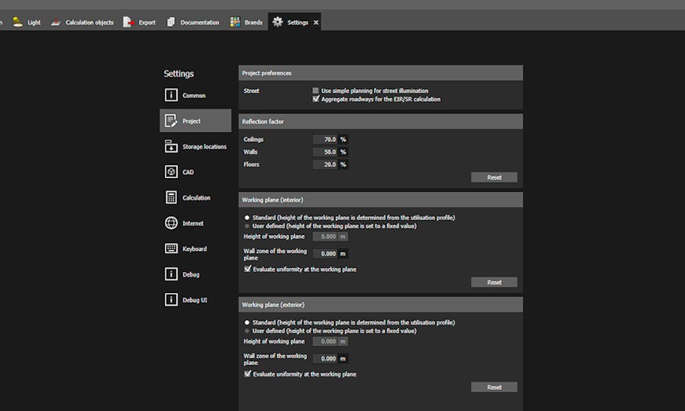

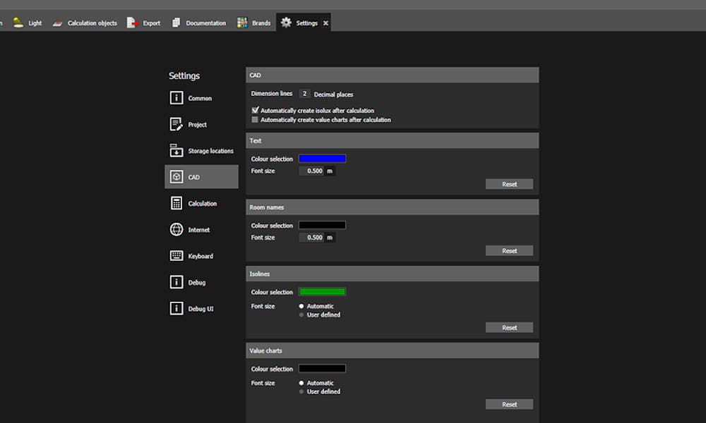

The UI for program and preset settings has been completely revised. You can adjust program settings as well as presets for objects here. If new objects are created in the planning, they will behave according to their presets
Presets for use planes
  • Choice between DIALux standard (norm) or self-defined values
  • Default value for height
  • Default value for edge zone
  • Selection between evaluate overall uniformity or not
Default values for texts and diagrams
  • Default color and size for room names (room stamps)
  • Default color and size for text objects
  • Default color and size for value graphs
  • Default color and size for isolux lines
Default settings for reflectance of rooms
  • Default reflectance for ceiling
  • Default reflectance for walls
  • Default reflectance for floor

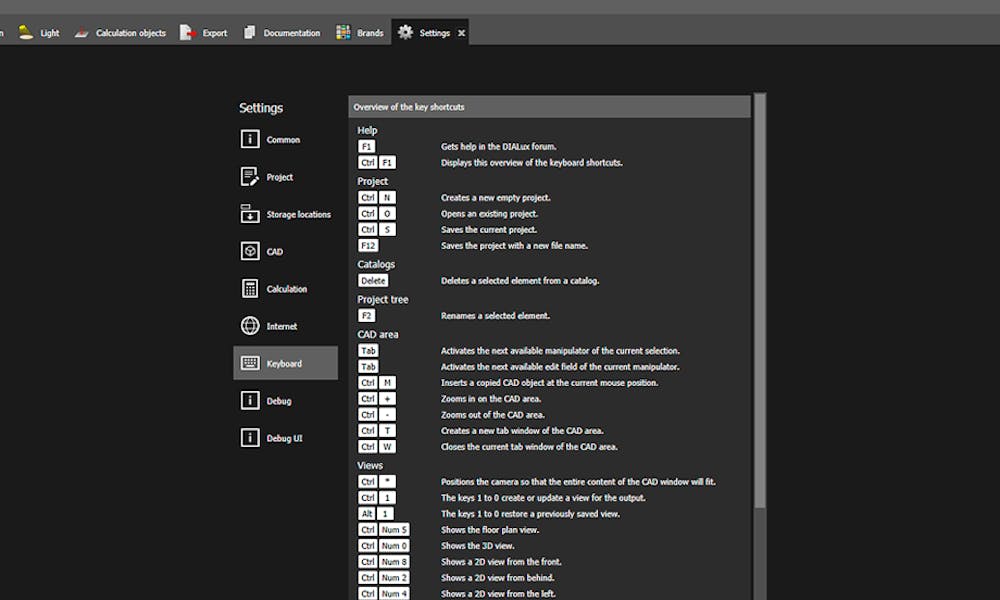

Overview of all hotkeys
  • List of available hotkeys (overview only, no customization possible!)

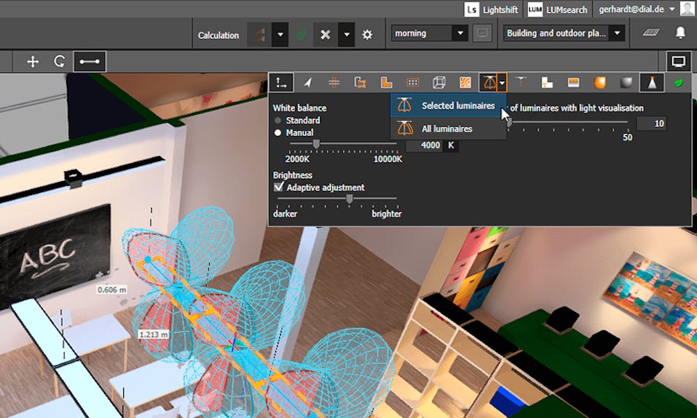

You can customize the behavior when displaying light distribution curves in CAD. There is a choice between: "Show all" or "Show only those whose luminaires are currently selected".

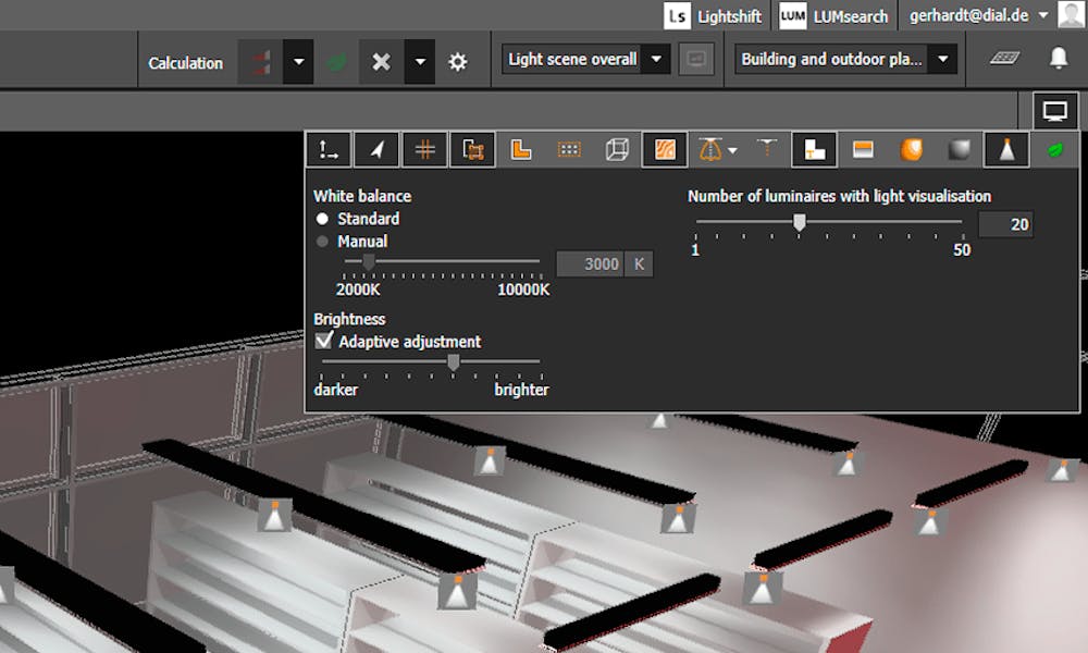

The number of luminaires in the live visualization can be set. Depending on the performance of the computer, you can select between 1 and 50 luminaires simultaneously for the light visualization.

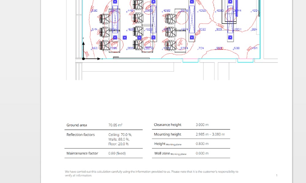

Important spatial information is displayed more prominently in the spatial summary. The height and edge zone of the working plane (if available in the area) have been added. We have also added this information to the PowerPoint layouts.

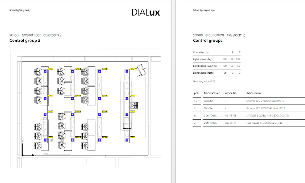

The documentation of dimming values and control groups is back. DIALux will document this topic graphically in the future. For each control group there is a plan in which all associated luminaires are marked. You can easily see which luminaires are controlled/dimmed together.
This is supplemented by a table with dimming values. This table shows per control group their dimming states depending on the light scene. A luminaire list rounds off the output and is used to identify luminaire types in the plan. DIALux offers only the table again additionally as separate output for the complete project.
Such documentation can be created for individual rooms, complete floors and the outdoor area.

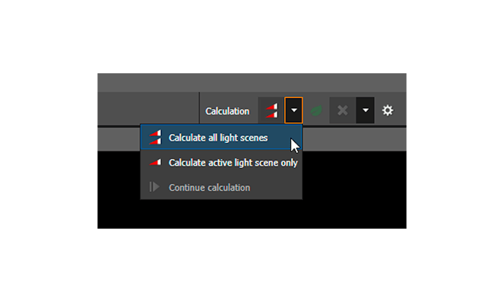

The control for starting the calculation has changed: The selection whether all light scenes or only the active light scene are calculated is now located in a selection box. The function "Continue calculation" can now also be found here. The start of the energy calculation and the calculation settings are located on separate buttons. Discarding results can be done selectively in a selection box.
