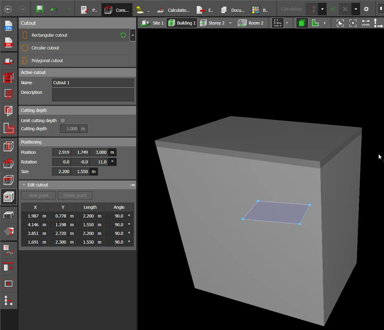

cutout impossible from first floor to ground floor
Did you experience this ?
I cannot create cutout on first floor to ground floor. it works on walls but not on floor..
i do it for years when double height is needed..never faced that before.
Thanks
View 3 more replies
Manuel
DIALux staff
This is still possible if you are in the floor plan view and on the upper storey.
do you mean previous functionality has been removed ?
