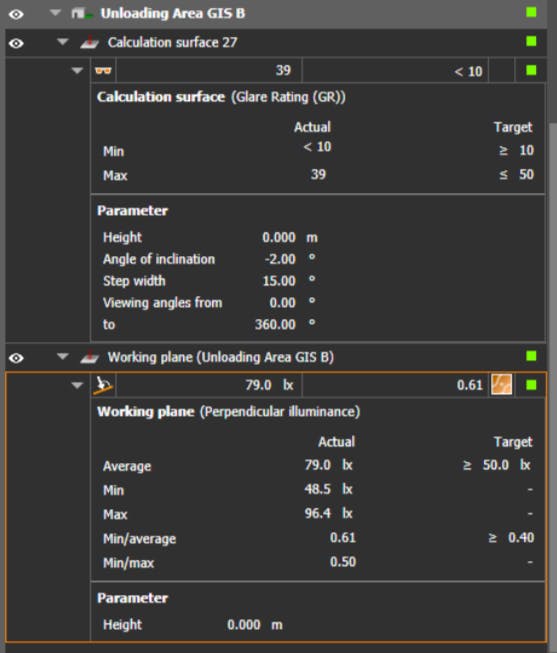

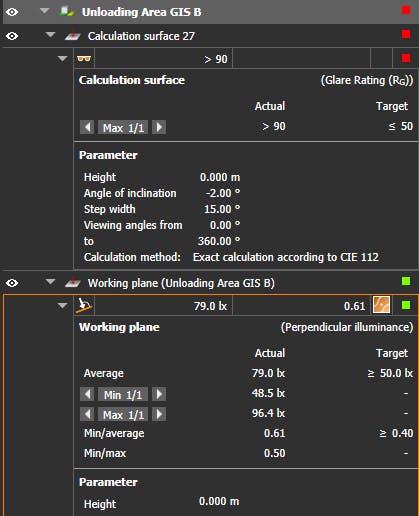

Hi all,
so I worked on outdoor lighting calculation in 12.1 version of dialux and when I open the same project file in 13.1 version there is significant difference in GR Calculation value. Look at the pictures for example. First picture shows results in 13.1 version and second shown results from 12.1 version. in both cases I was using Exact calc. according to CIE 112. Why are results so different and what results are relevant for report? Thank you
