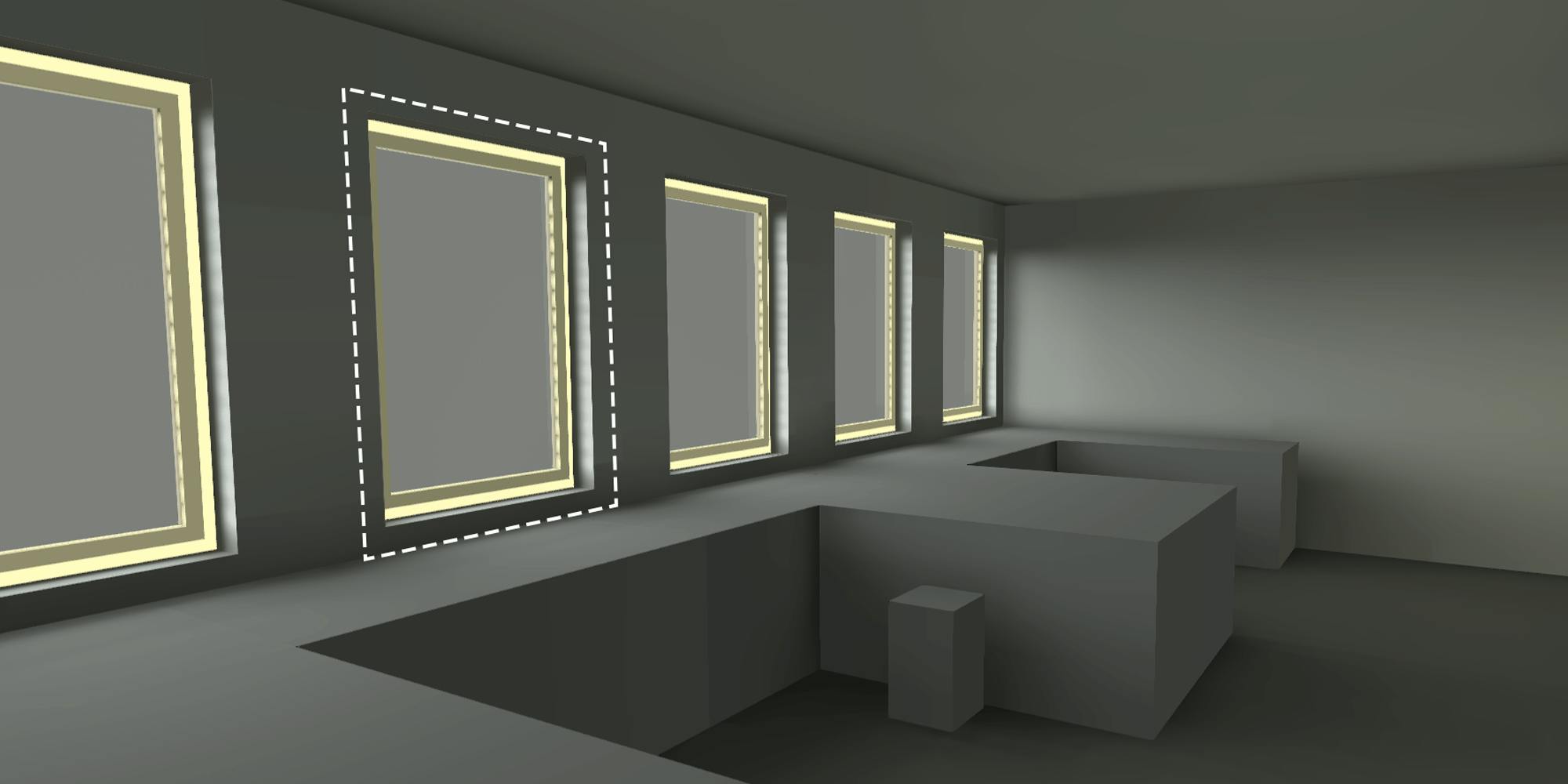

DIALux receives this information about the ambient conditions via the defined spaces. You must therefore define these in the room. For example, daylight has a different effect if a clean room such as a laboratory or office is defined than in a workshop or similar. You make these decisions by defining a suitable space and selecting an application profile.
With IFC models in particular, it may be necessary to reconstruct spaces in order to include the influence of daylight. These are often missing in the IFC model. As a result, the windows in these rooms are not marked for the daylight calculation.
In DIALux evo there is a tool called ‘Building openings’. You can use this to check whether all the windows you want to include in the calculation are also labelled.
