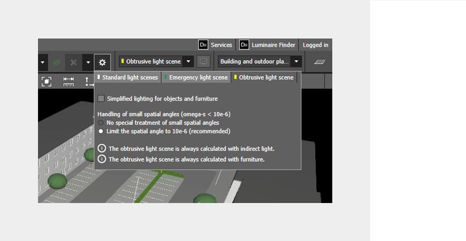

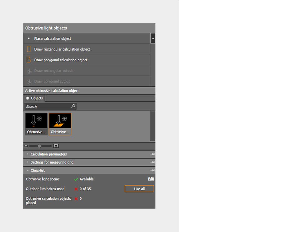

The obtrusive light scene calculation with new values has been ready to use for a while now in the testing environment. We've added some great shortcuts and helpful tips to make creating light scenes and selecting luminaires easier. Now there is also a checklist in the tool for obtrusive light that shows you what is missing!

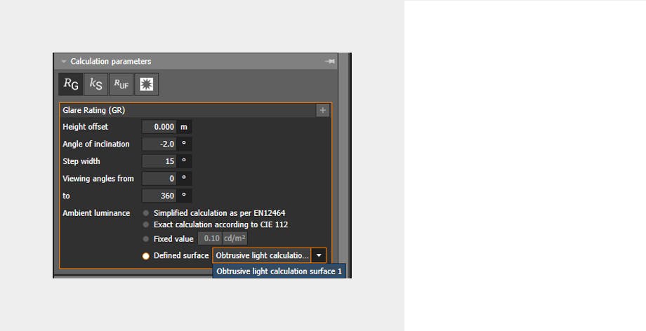

The calculation parameters for obtrusive light differ from those for normal calculations. That is why we have created a separate section for obtrusive light in the calculation settings.

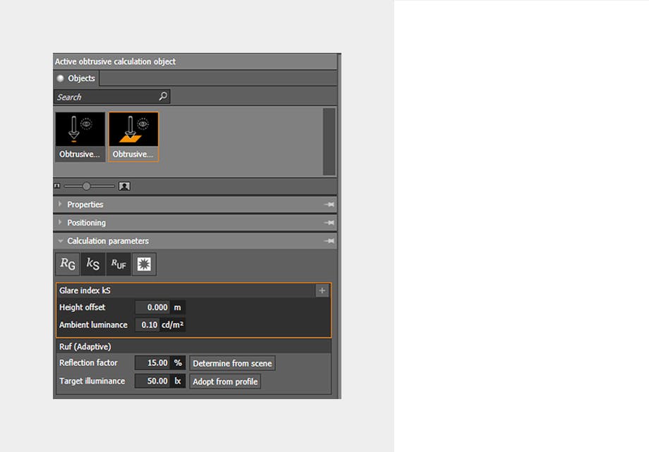

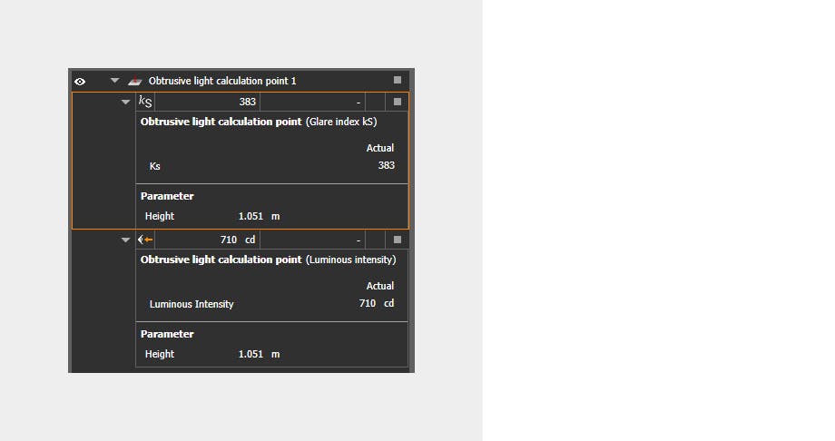

We have developed brand new calculation points and grids especially for obtrusive light values: ks, I, Ruf. The call grid requires additional parameters such as target illuminance and reflection, which you can take directly from the scene.
Finally, we soon have a new calculation area for veiling luminance. You can use it as an alternative to the previous calculation for the GR calculation or simply define the background veiling luminance as a fixed value.
